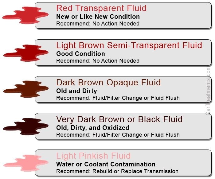

Check fluid level running @operating temperature. Also check fluid condition:
