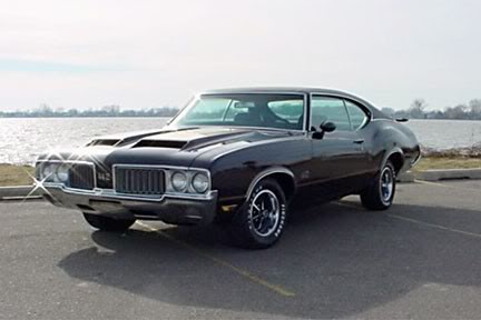

Father's Day weekend fellas...... so how about a Father's Oldsmobile?
Attached Thumbnails Lower Profile 265/70/R16 Tires on stock 16s HUMMER H3 Rims-oldsfront1.jpg

Happy Father's Day to you, Doc
