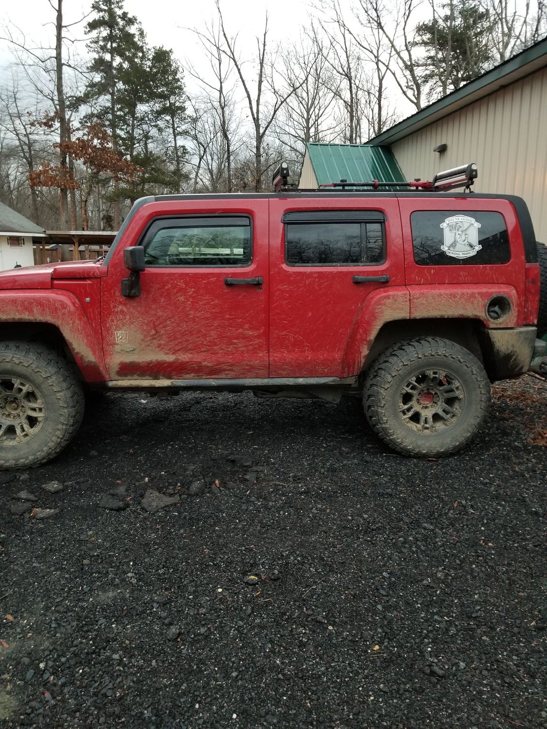

Has anyone ever come up with a solution for the 7 minute key fob lockout? I own 2 2007 hummer H3 one stock yellow (my wife) and one custom red upgraded stereo alpine touch screen and JLG amp (1200 watts JL audio 4x4 12"×12" sub), wheels and tires(35" toyos), bilstien shocks, 10k milemarker winch, custom roof rack with hi-lift jack and fishing rod holder, k&N air, Optima red top, full magnaflow SS system including header, and all protected inside with weathertech
mats.
