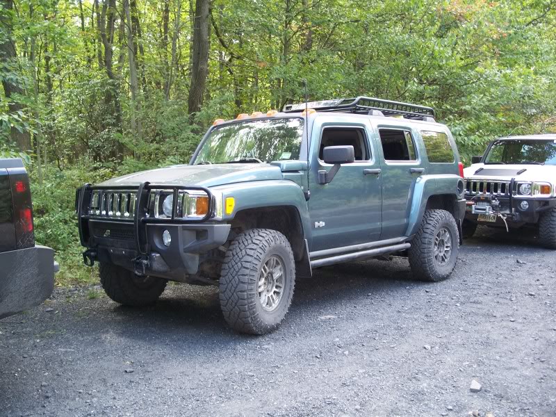

Here's mine with just a T-bar adjustment & 33" (285/75/16) Goodyear Duratracs.

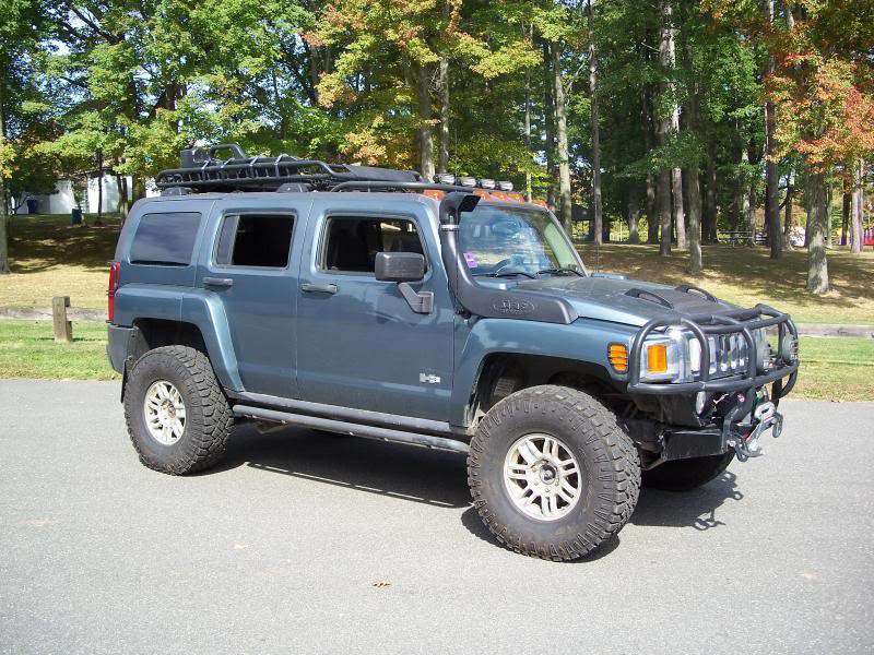

But I wanted more, so 1" body lift & 35" (315/75/16) Duratracs.
