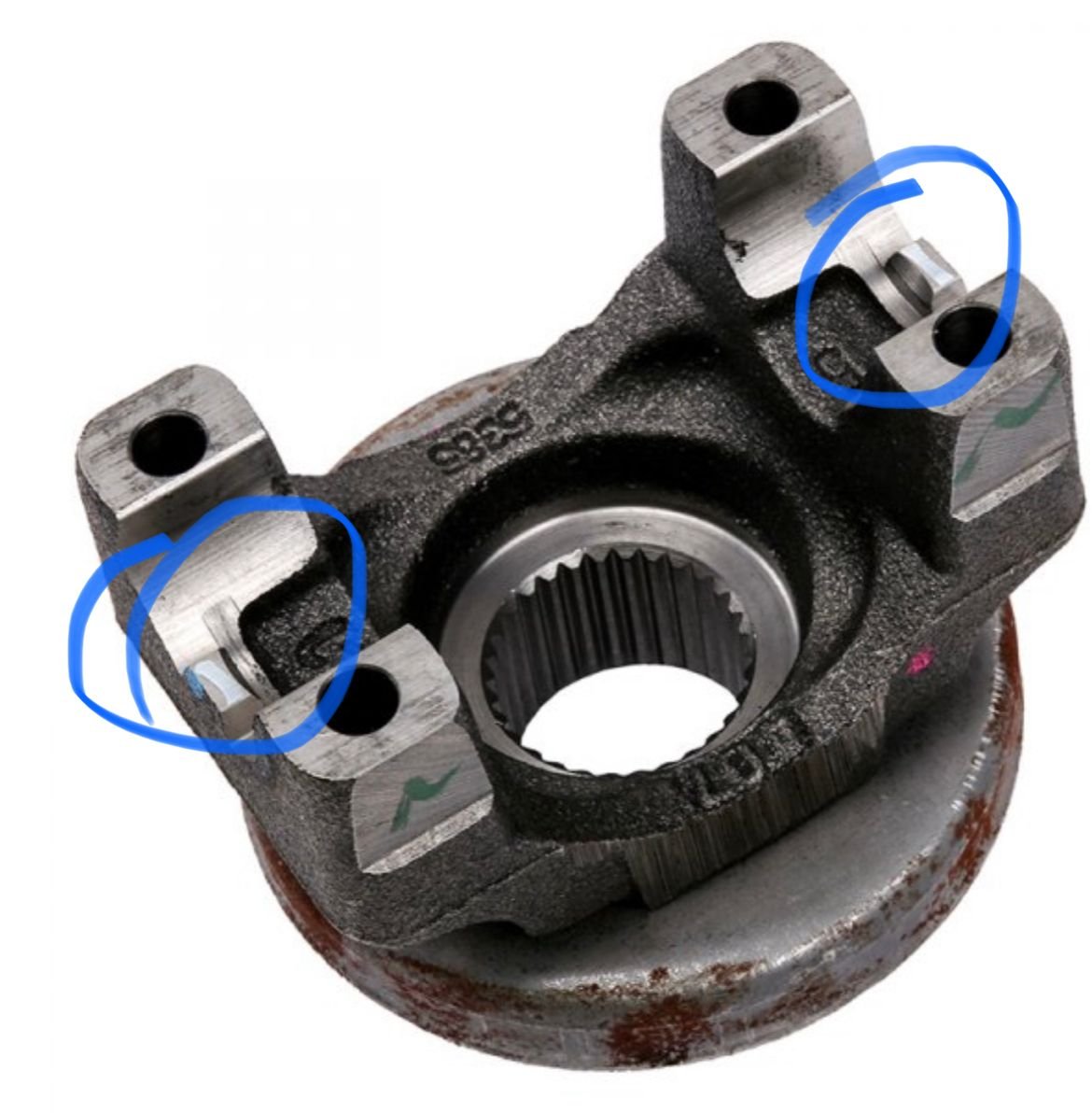

It is called rust and corrosion. You need to break its hold. With a rubber mallet or small hammer, TAP........ that is TAP (do not bash, whack or beat) the Yoke that holds the U Joint on the shaft end, then move drive shaft away from the front diff. Might want to wrap the U Joint Caps with masking tale so they do not come apart and drop Needle Bearings all over.
Old Jun 29, 2022 | 12:42 PM
Another tip. If you are laying under the H3, put a foot on a front tire and push it to move the Pinion Yoke clockwise/counter-clockwise a bit to line the U Joint back up during assembly, or help with taking it apart.

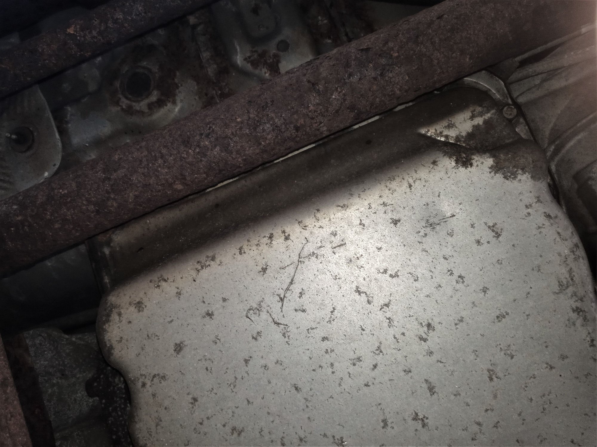

Dropping the transmission pan does not require any further disassembly. Easy to drop/reinstall with the proper tools!

Thanks for the replies. I tried tapping with a rubber hammer and pulling with a screen driver. But it doesn't budge. I'm afraid of breaking something by applying too much force.
Should the bar come back a little bit or just sideways?
See the picture:
The yoke has these two side things that Look like retainers for the bar. Are those causing me all the problems, or is it just Rust and corrosion?

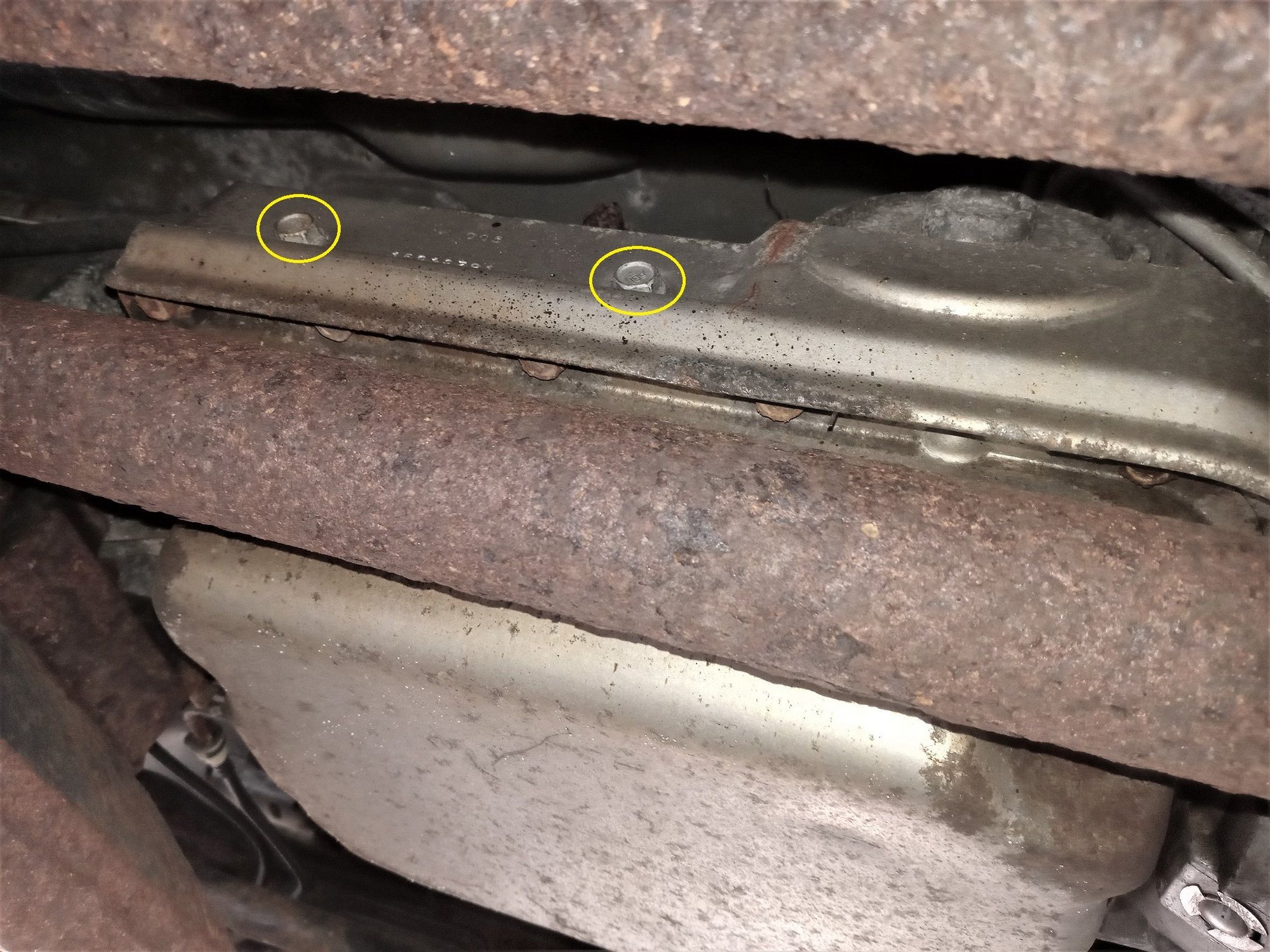

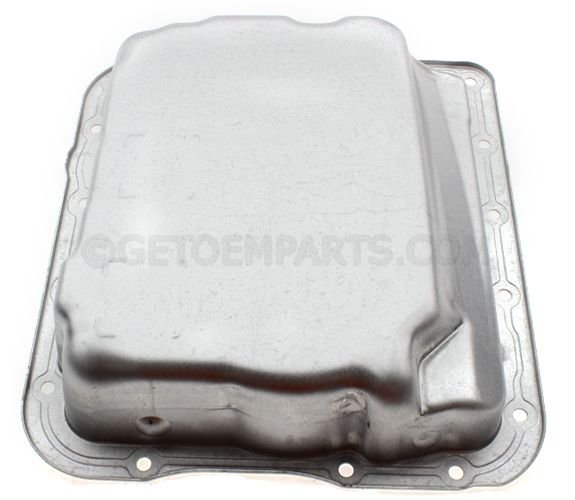

Simply remove the 13mm bolts on the heat shield, out of the way, makes easier access to the transmission pan bolts above the front drive shaft. The H3 Transmission pan has a cutout for the drive shaft so it drops without removal.
