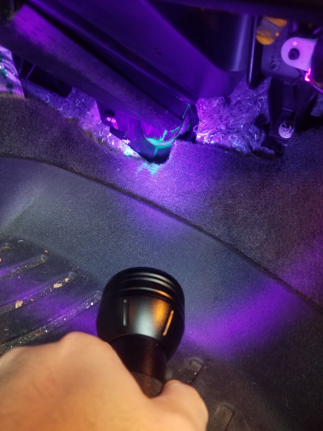

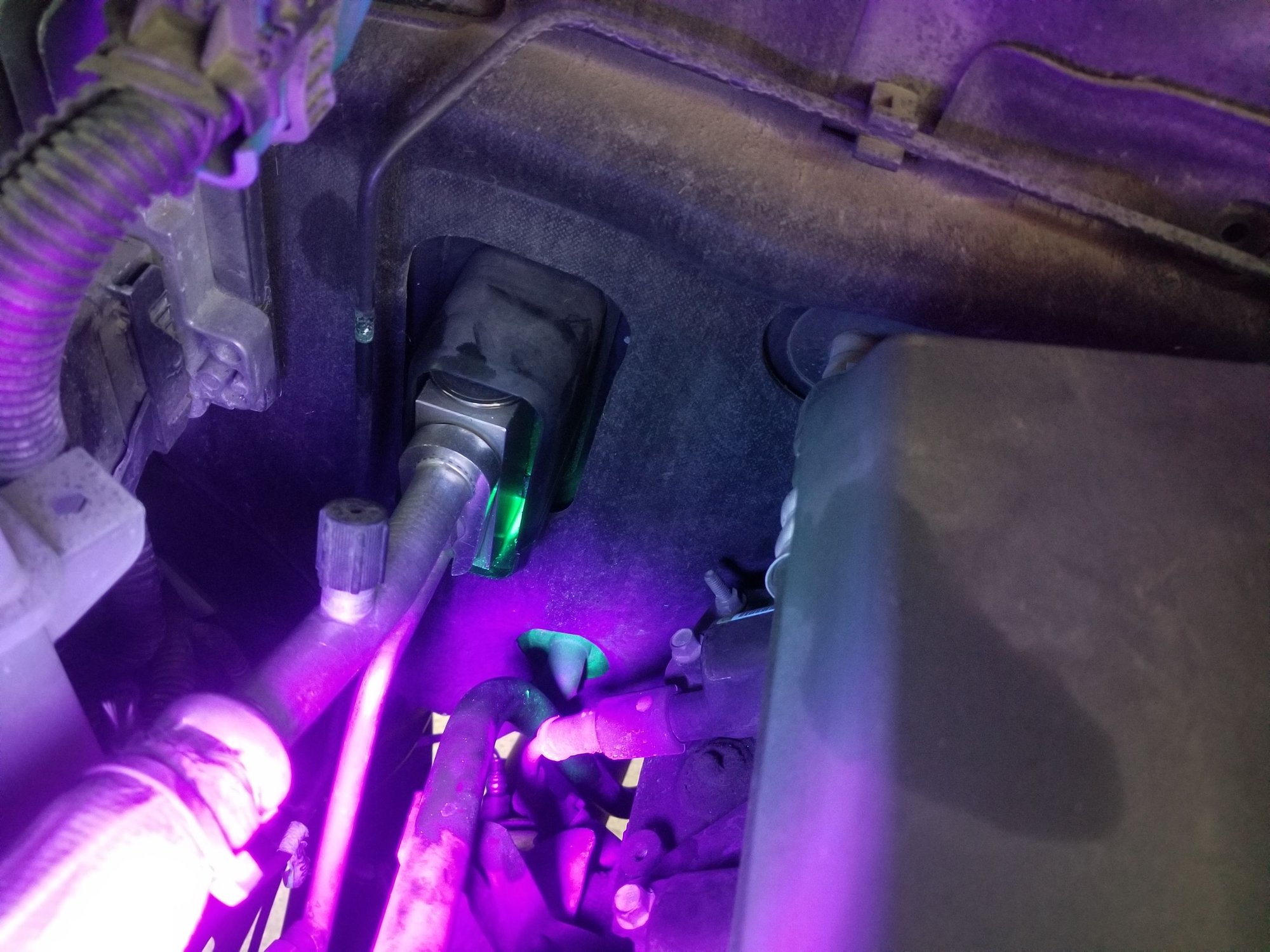

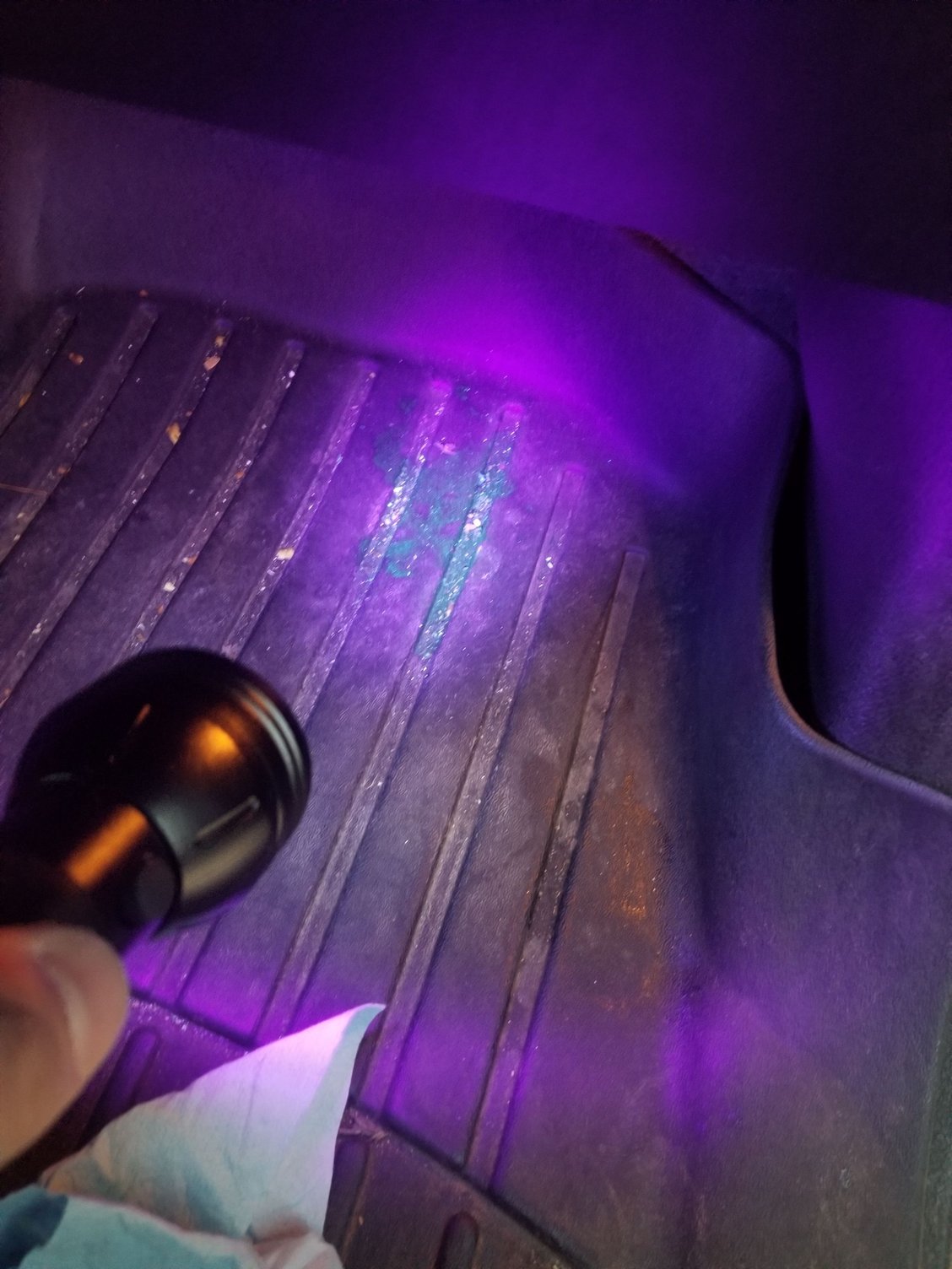

I'm wondering if it's just the expansion valve and its soaking the drain seal which is causing the inside to leak. What are your thoughts?

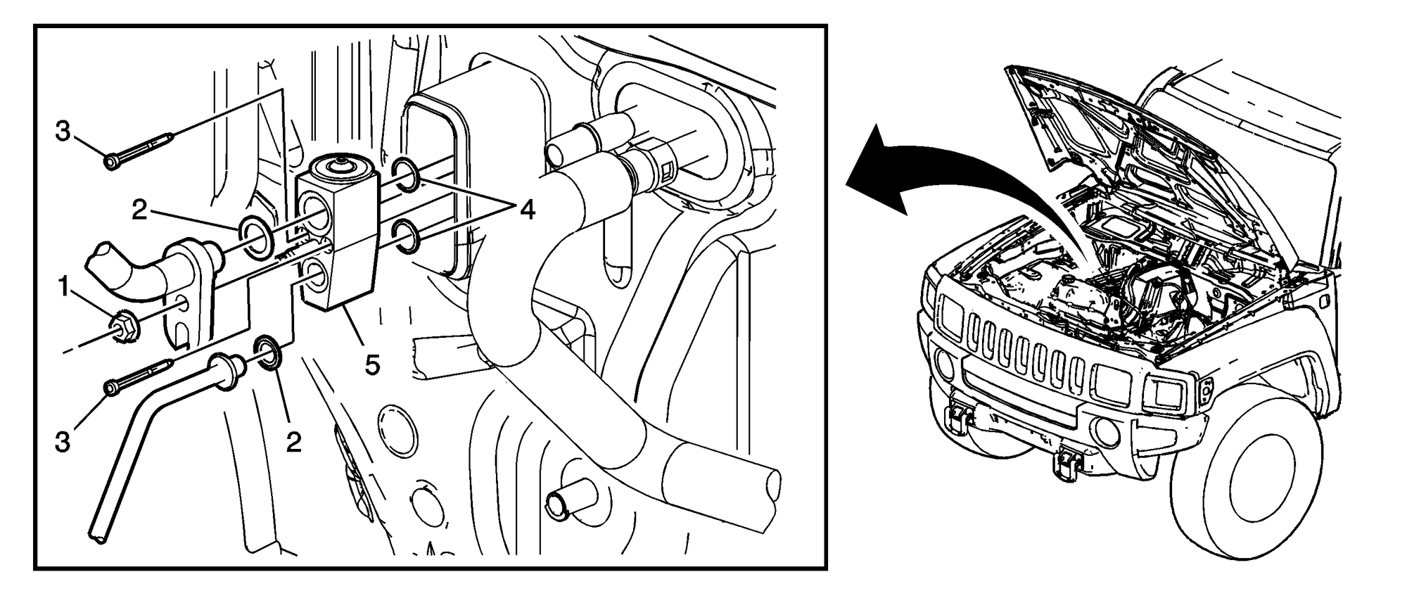

The expansion block is mounted with 2 bolts and 1 stud & nut, seals on both sides.
You can check/tighten the 13mm nut on the line to the expansion block, yet there are bolts under, that would require a/c evacuate/recharge system to check.

Does anyone have instructions on how to remove the hvac assembly so I can replace the evaporator. Seems to be leaking from the evaporator.
