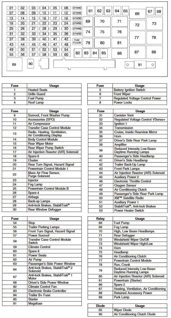

There is a solenoid that locks your key in the ignition if you lose battery power. Double check your battery connections and make sure you did not blow any fuses. When you said the car died while replacing the radio; makes it sound like you did not disconnect the battery before starting. Always disconnect the battery before unplugging or unwiring anything in the car (even the radio). You may have grounded out a hot lead and popped a fuse. If you have the I5 motor, the fuse box is in front of the battery on the drivers side.

Check your battery connections have someone jump your battery also. Might be one of those square plug in fuses in fuse box under hood. Logic probe helps can just touch the spot provided on top of fuses for checking. Finish the work on the radio per the instructions hate to find the fuse only to blow it twice. If you find fuse blown and it burns again maybe your radio is miswired also. Inline fuses at radio can save you getting stuck if something goes wrong better to blow these than the one running your car. Tap the black Relay squares in the fuse box with screwdriver handle lightly if power comes back on even briefly it's a bad Relay. Six of the Relay are same so you can swap them around see if anything changes. Might be crappy battery cables clean them good then tighten. Your going to find it don't stress.🙄

You blew a fuse. Check #5 & #33, it's possible that you could have killed the megafuse #91
