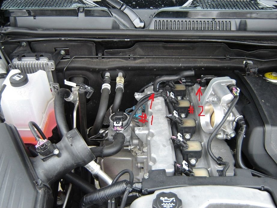

where is the valve cover breather . Because when I took it out before I soaked it in like anti greaser and all and cleaned it pretty good but maybe I didn’t clean where that spot is
Old Nov 8, 2024 | 01:28 PM
There are two" #1 below is the primary from the bottom of the Air Intake Resonator Box; and, #2 is the secondary from the Intake Manifold itself. #1 has some kind of fiber mesh screen under it which can gat clogged/goobered up with oil/dirt/crud....
are you talking about those? Ya I never took those off when I was cleaning it I will def take them off and clean it and let it maybe soak overnight in a degreaser. Is that screen you talking about replaceable ? Or do I just clean it and put it back?
Old Nov 8, 2024 | 02:07 PM
It is not a serviceable part, nothing is intended to be replaced. There are threads on people that cleaned them and reinstalled at the Colly/Canyon forums.
how do you clean that screen? From the top?

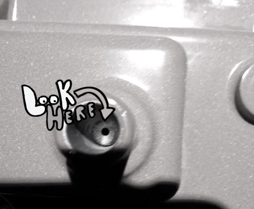

A crankcase ventilation system is used to consume crankcase vapors created during the combustion process instead of venting them to the atmosphere.
Fresh air is supplied through a filter to the crankcase, the crankcase mixes the fresh air with the blow-by gases and then passed through a positive crankcase ventilation (PCV) orificed tube into the intake manifold.
The PCV orificed tube restricts the flow rate of the blow-by gases using a 2.5 mm (0.098 in) orifice located in the camshaft cover tube. If abnormal operating conditions arise, the system is designed to allow excessive amounts of blow-by gases to back flow through the crankcase ventilation fresh air tube into the air cleaner resonator in order to be consumed by normal combustion.
