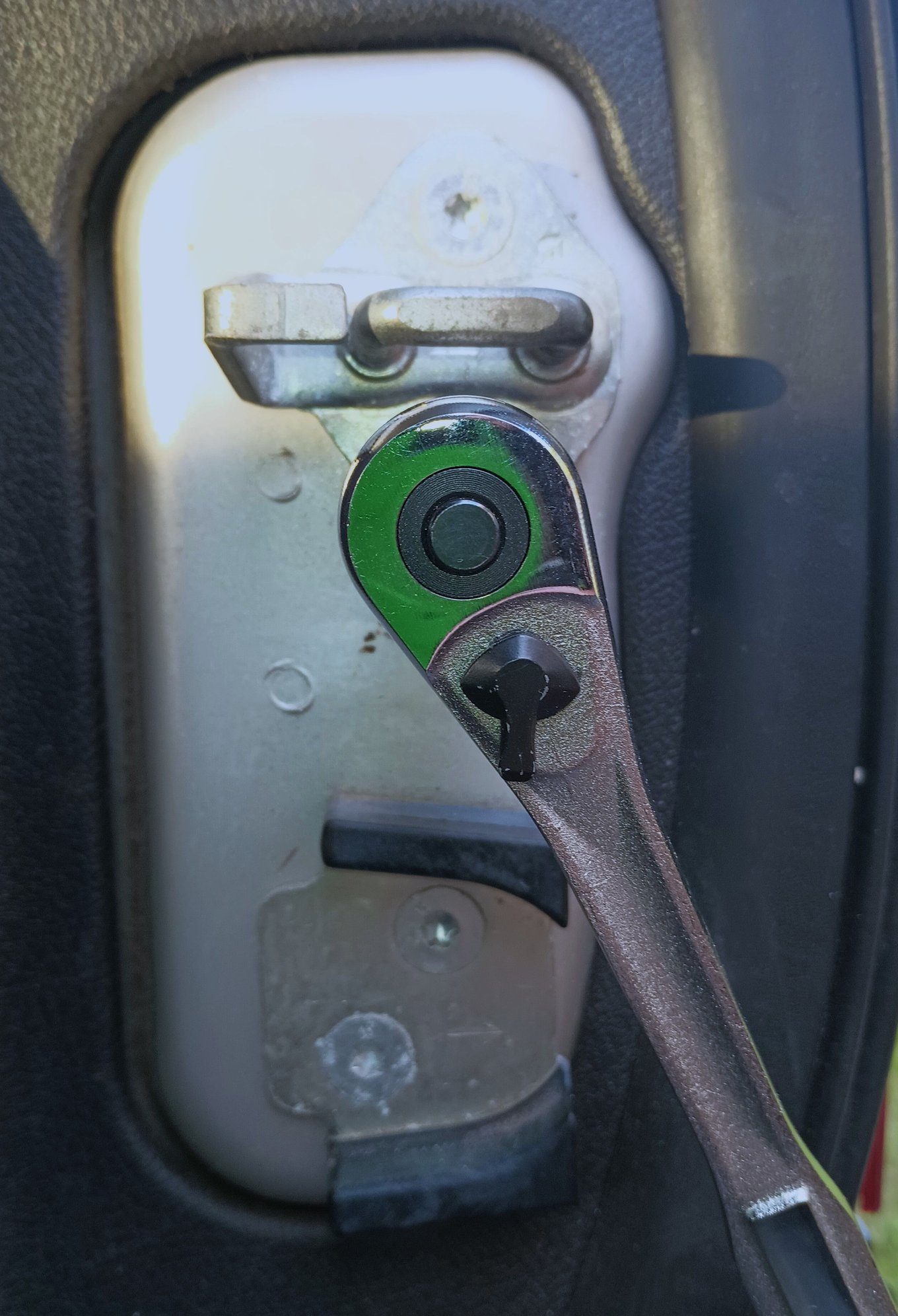

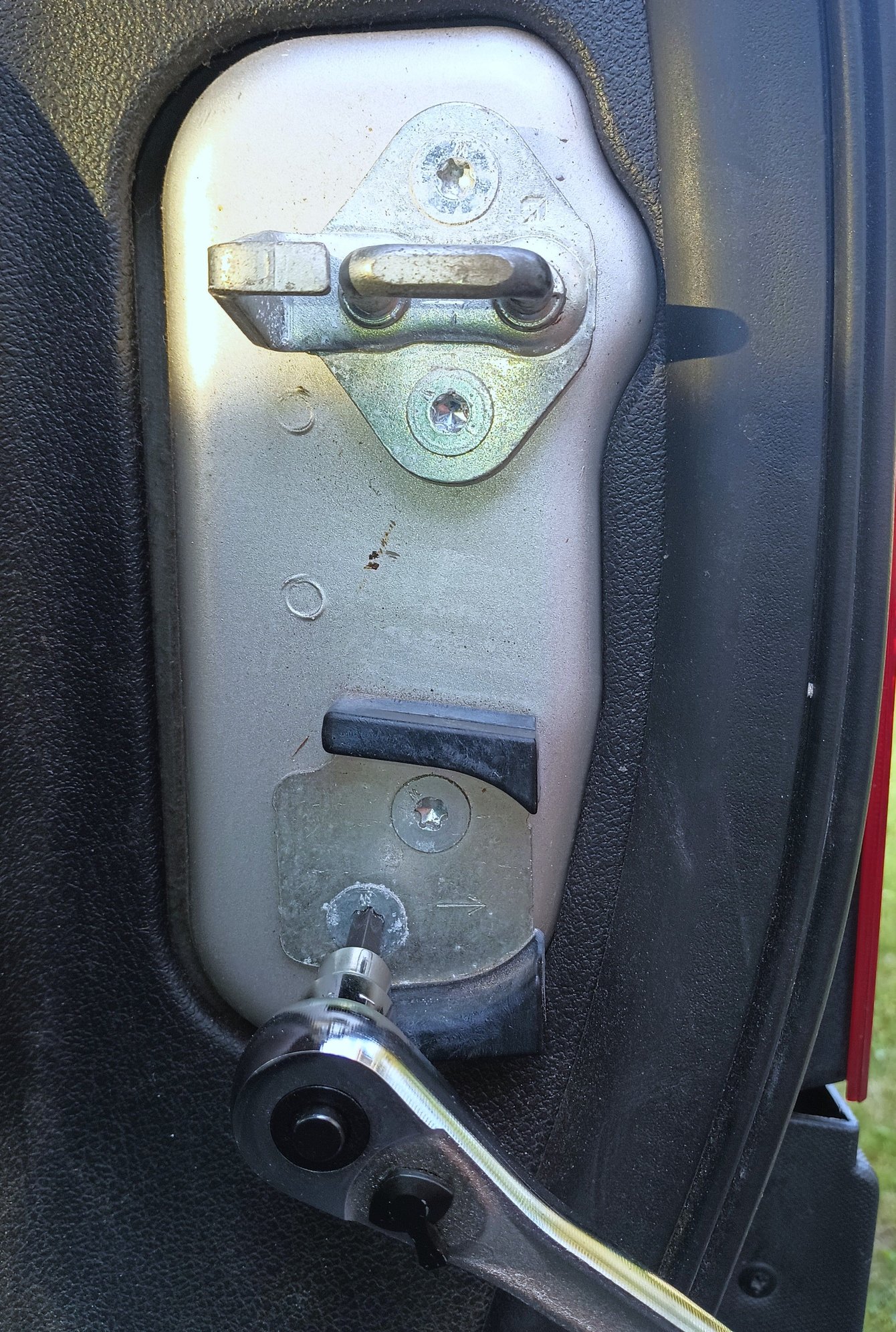

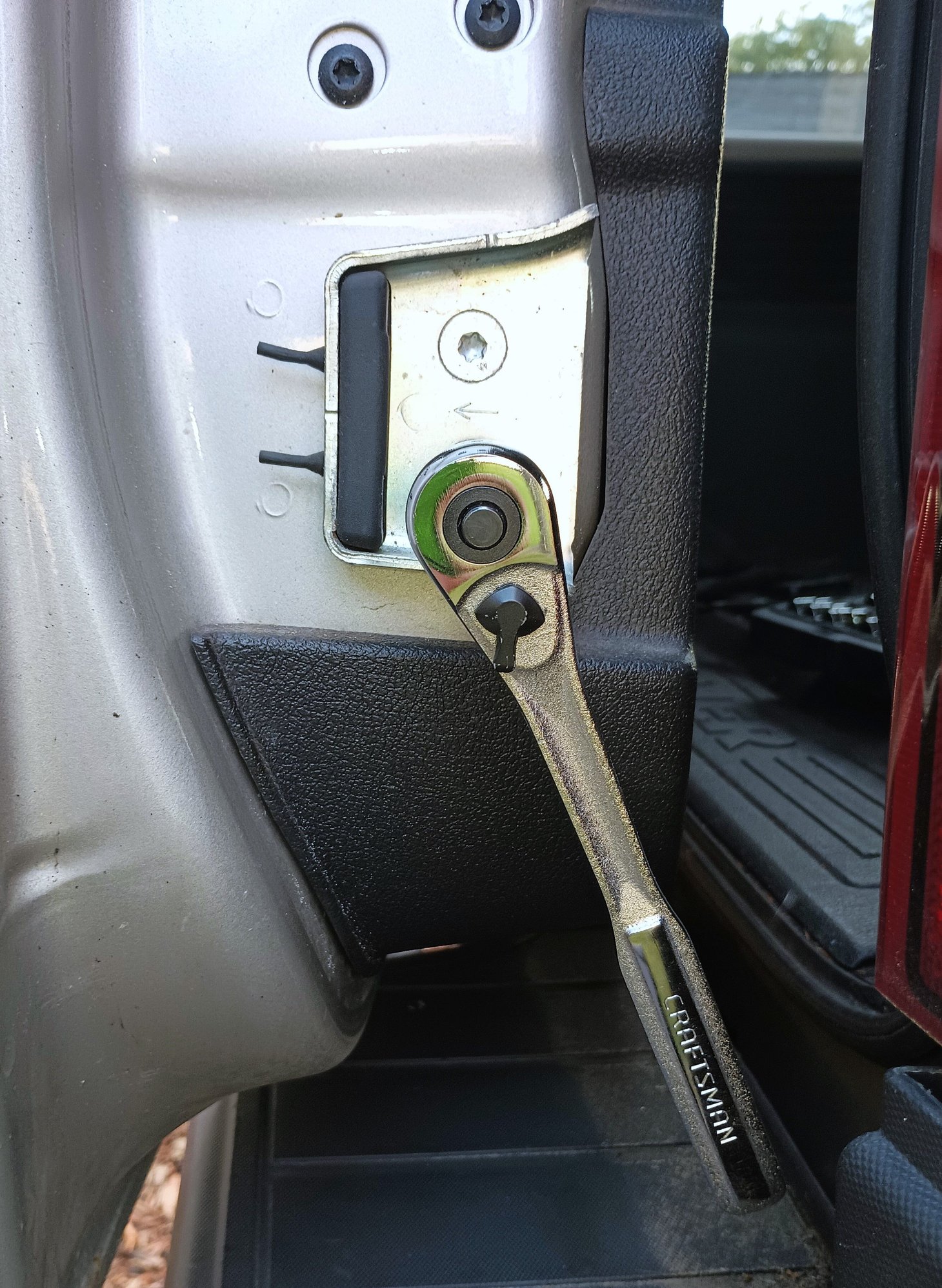

2. LOOK FOR LOOSE BOLTS - Really nothing crazy here; I simply looked for loose bolts in the following areas:
i) Latch mechanism on the rear door (3x Torx Screws)
ii) Rubber Tapered Piece on the Rear Door itself (2x Torx screws)
iii) Rubber Piece inside the rear cargo door area (that fits into the rubber tapered piece on the door itself, 2x torx screws)
iv) Latch Piece inside the rear cargo door area (2x torx screws)
v) 8x bolts on the opposite side of the rear door (where it bolts/mounts onto the vehicles body).
While some of these were in fact just a hair loose, they were ultimately not the cause of my thumping, however I tightened them up anyways.

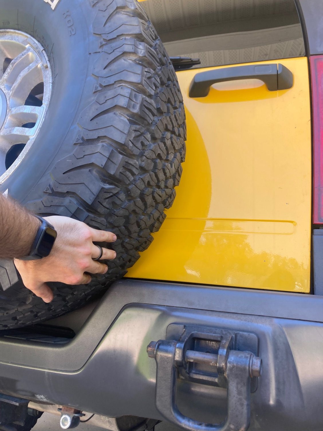

3. CHECK FOR UP/DOWN PLAY IN THE DOOR ITSELF - You can do this with or without the spare tire installed, but I feel it is a little easier without it installed (and if you test drive without the spare tire installed, it will be off anyways). Now you want to look for some up/down play in the door itself in the latch area when the door is closed and latched shut. Even if the door is slightly loose when closed and latched, it will still feel relatively tight and you may swear that there is no play in the rear door, however to truly test this (this is where having the spare tire removed comes into play), grab the spare tire mount and push UP on the rear door. Look very closely at the area where the latch and the rubber tapered pieces meet (basically just to the right of the door handle itself near where the metal meets the rear glass....to the right of that). Use a pretty decent amount of force to push up from the spare tire mount, then use some force to also push down. It may take multiple iterations of this "up-down" force to see any motion, and it may not be a whole lot either (you won't see something like an inch, instead it will be something in the realm of 1/8-1/4 of an inch, if that). It is especially tough to see this movement since the suspension will be rocking the vehicle as well, however really try to lock your eyes just to the right of the door handle at the edge of the rear door, and look for up/down motion. If there is any play in the door, this is where you will see it.
In my case, I noticed a small amount of up/down play in the rear door. Now I started looking into the metal tapered piece and the rubber pieces inside the vehicle. Turns out, the rubber pieces (inside the vehicle) that meet the metal tapered piece (on the door itself) were not meshing up quite as they should (it appears that the rubber pieces inside the vehicle are slightly worn out from age/wear). I'm going to go out on a limb and say that if there is any play in your rear door, it's probably because of this exact reason.
Fortunately, without replacing the part, this is actually a super easy (although jerry-rigged) fix.
Much easier to perform with the Spare Tire removed, however the idea is to push upwards from either the bottom of the spare tire, or from the bottom of the spare tire mount (tire removed). Don't be afraid to give it a considerable amount of force; even a "loose" door will still feel fairly tight.
Look just to the right of the door handle to where metal meets the rear glass. When pushing upwards & downwards from either the spare tire or the tire mount, you should be able to see any up/down motion, indicating that the door is loose. You won't see a lot of movement, but even the smallest amount is enough to cause the violent thumps from the back of the vehicle

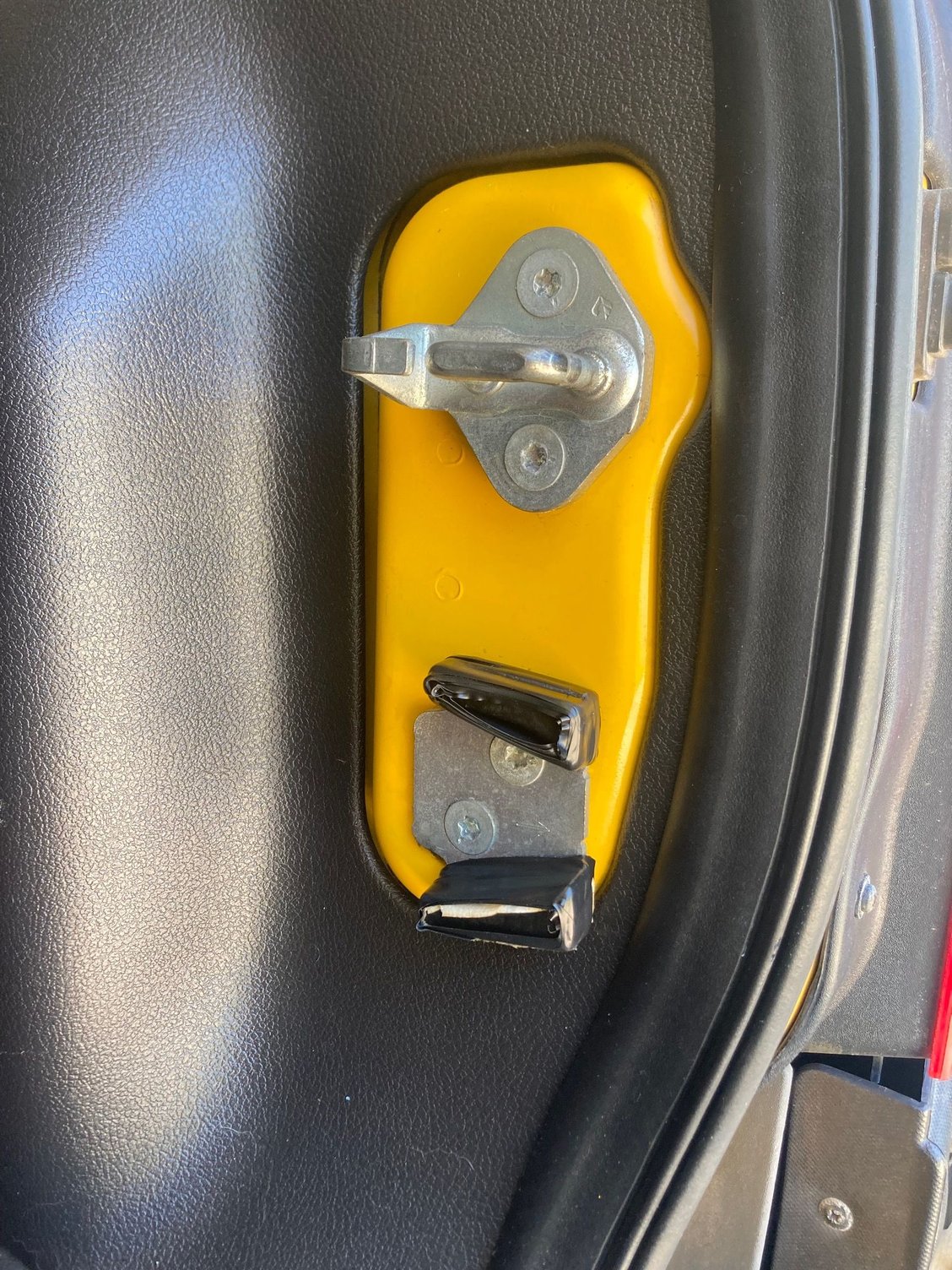

4. "THICKEN" UP THE RUBBER PIECES INSIDE THE VEHICLE BY APPLYING ELECTRICAL TAPE OVER THEM - Pretty much says it all; I applied a generous amount of electrical tape over the two rubber pieces. If either one of the rubber pieces are initially too "slick" for the electrical tape to stick, (which happened to me on the lower piece, but not the upper), I simply applied a small layer of scotch tape first (more gritty than electrical tape), then followed with electrical tape afterwards.
Upper rubber piece with electrical tape applied. The lower piece was very slick, so I applied some scotch tape first, then followed with more electrical tape after.
Once you've applied a generous amount of tape, TEST to make sure the door is not too hard to close. Give the rear door a pretty hard close and take note of how difficult it is to re-open the door with the door handle. You'll know you're on the right track if the door handle has more resistance than usual to re-open the door, but it shouldn't be so difficult that you risk feeling like you're going to pull the door handle out of the door to open it. If you put too much electrical tape on at first (like I did), simply remove a little bit at a time until the door handle becomes more loose, and easier to open. To re-iterate, if done properly, the rear door should be harder (than before) to open, but not so much that it takes a considerable amount of effort (risk damaging the door handle).
Lastly, when you think you have it right, re-perform the forceful push up/down test on the spare tire mount. If you applied the proper amount of tape, the previous up/down motion you saw should be gone.
Finished product.
