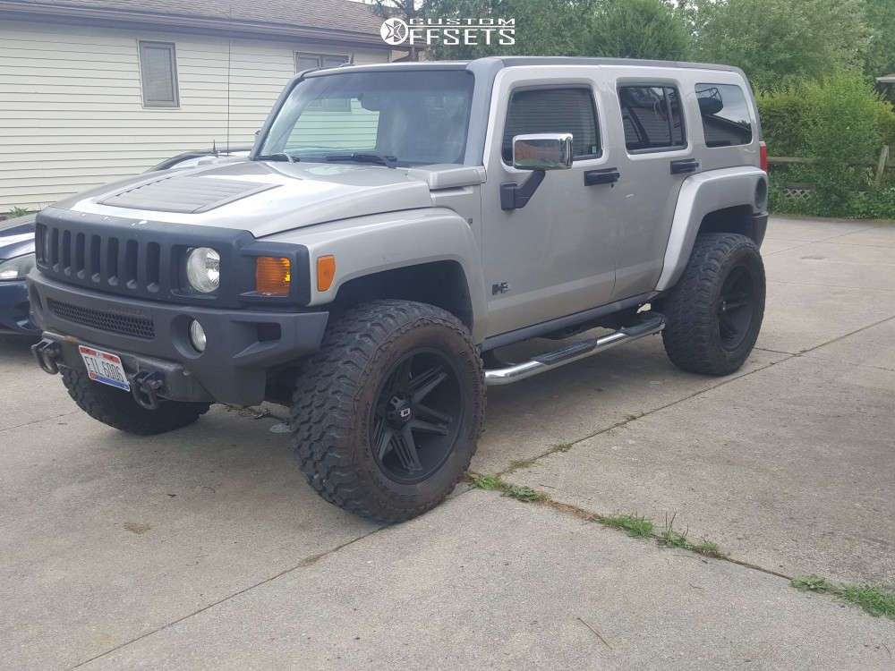

Vision Razor 20x10 -25
Achilles Desert Hawk X-mt 35"x12.5"
2 inch level Leveling Kit
Ok so this one has 35 tires on 20 X 10 but -25 offset.. the tire height is good.. but maybe just a little too sticking out ...the 20X 10 -19 offsets that I like would be a little less..

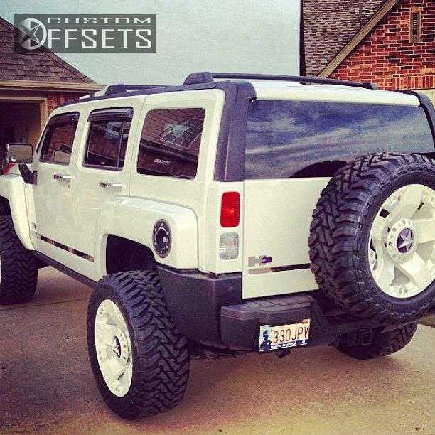

XD Xd775 18x9 0
Mastercraft Courser Mxt 305/60
OEM Stock
Ok even though these are 18s it shows a 0 offset with a 9 inch.. this is the stance I guess I would have with the other 20X9 0 offset...vs the 20X 10 -19 offset.. correct..

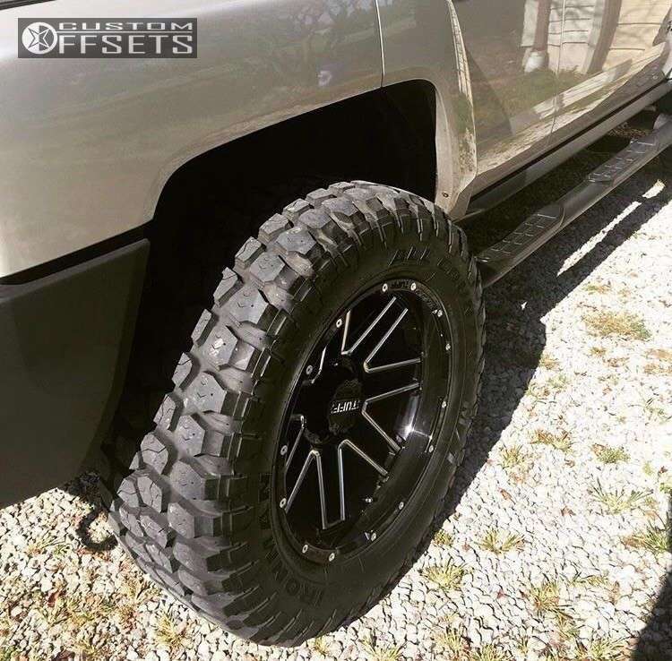

Tuff T17 20x10 -19
Hercules All Country M/t 35"x12.5"
Stock Suspension
Ok this would be the closest thing to the ones I would want.. -19 offset about the same on 35's Id rather be on 33 X 12.5 but if I ordered the 20 X 10 -19's I guess this is the stance I would have vs the 20 X 9 0 offset

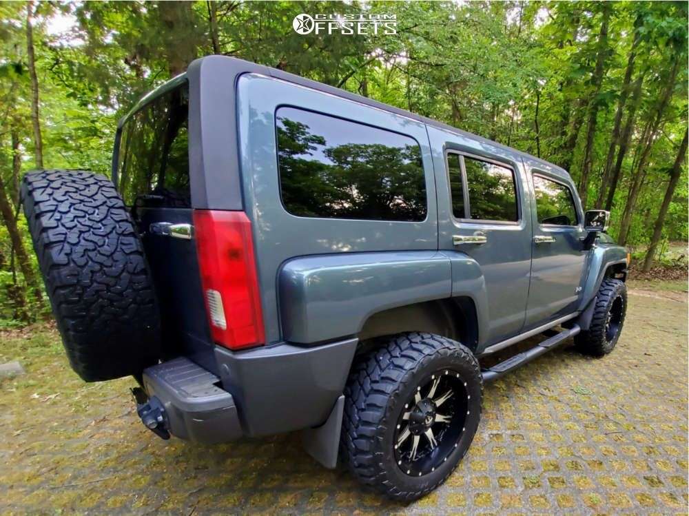

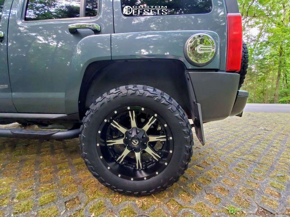

Fuel Nutz 20x10 -12
Mastercraft Courser Mxt 33"x12.5"
Stock Suspension
This last one I like alot.. I like the stance it has and how the tires look very meaty.. and the -12 offset is even less sticking out.. I like it so much I thought about just replicating the order at least I can see exactly how they look and I think these would look nice on a black hummer.. I wanted all chrome but these really look nice with the lip and black and chrome.. in any event this look wouldnt be too far off from my 1st choice of 20 X 10 - 18 on 33's

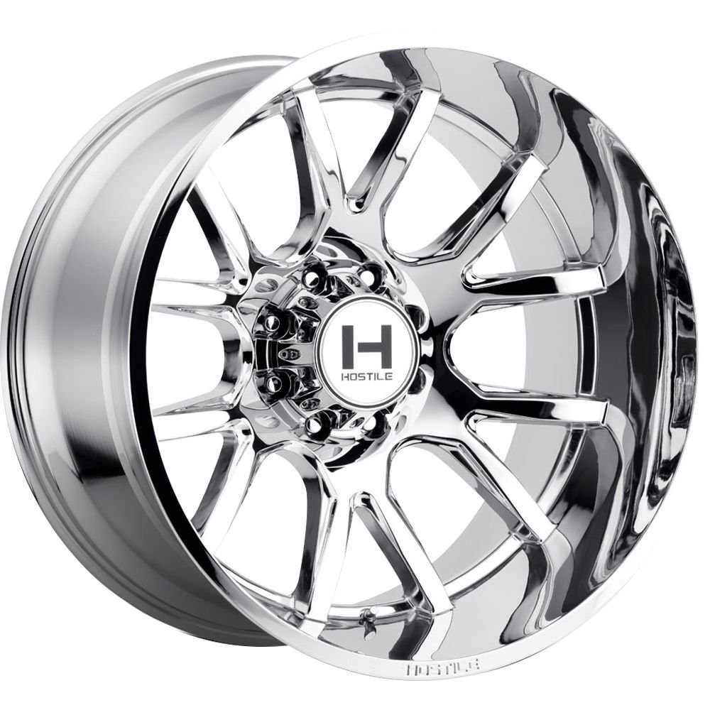

.here is the Hostile Rage in a 20 X 10 -19 offset ... what do you think would ook better on a black h3 with chrome accents already... the Fuel Nutz black and chrome center or the all chrome Hostile Rage..
