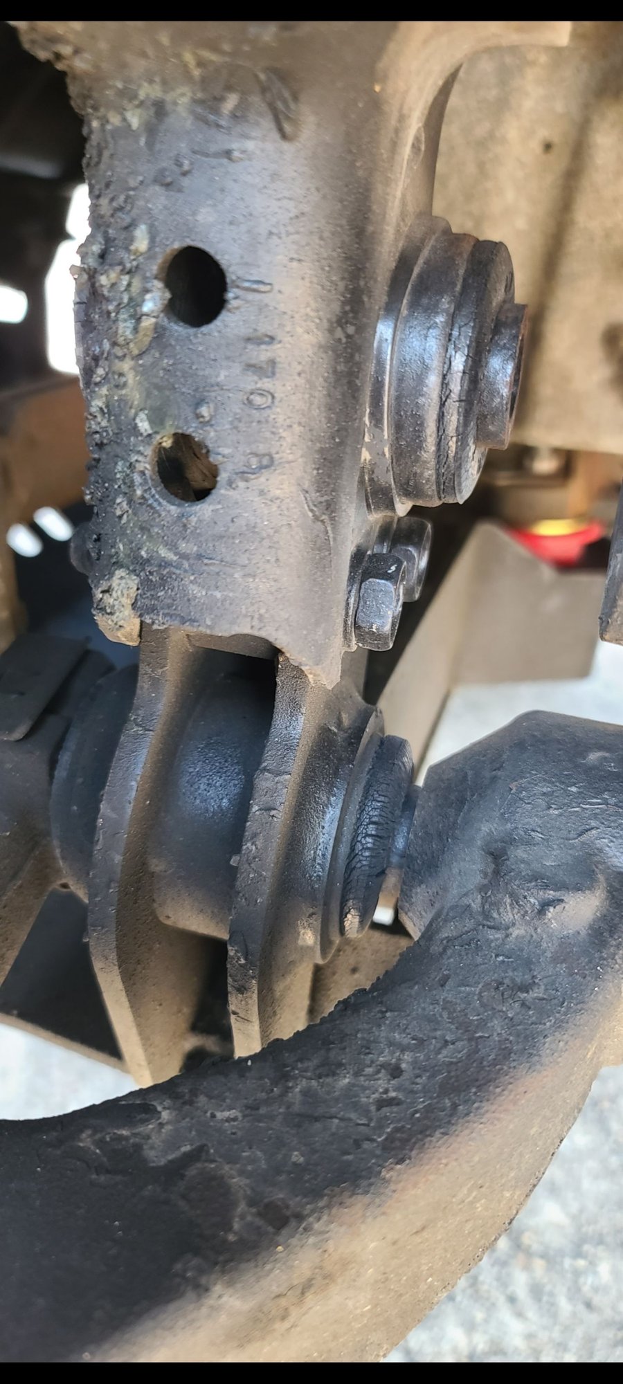

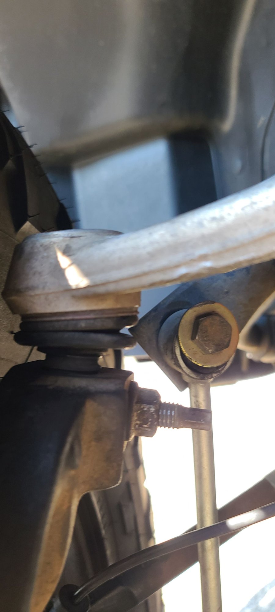

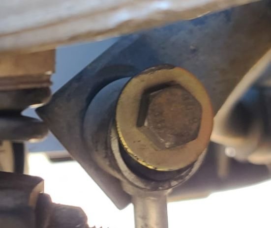

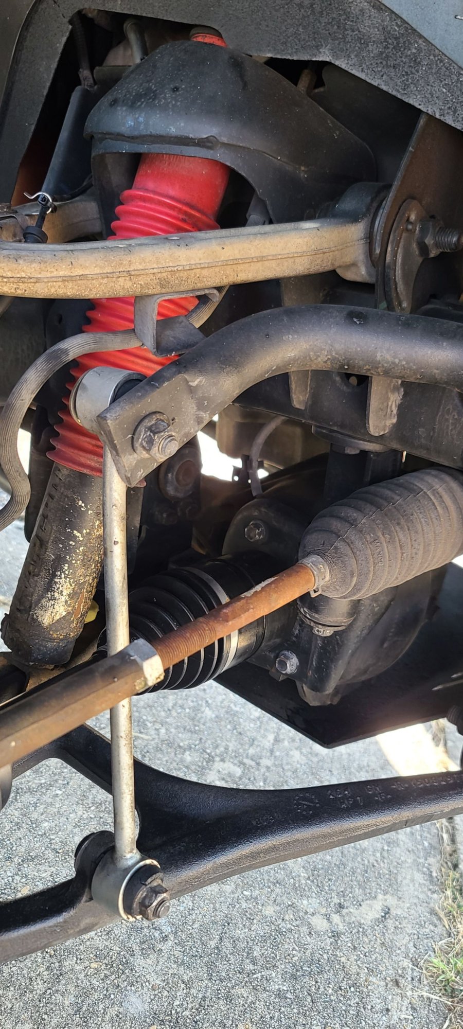

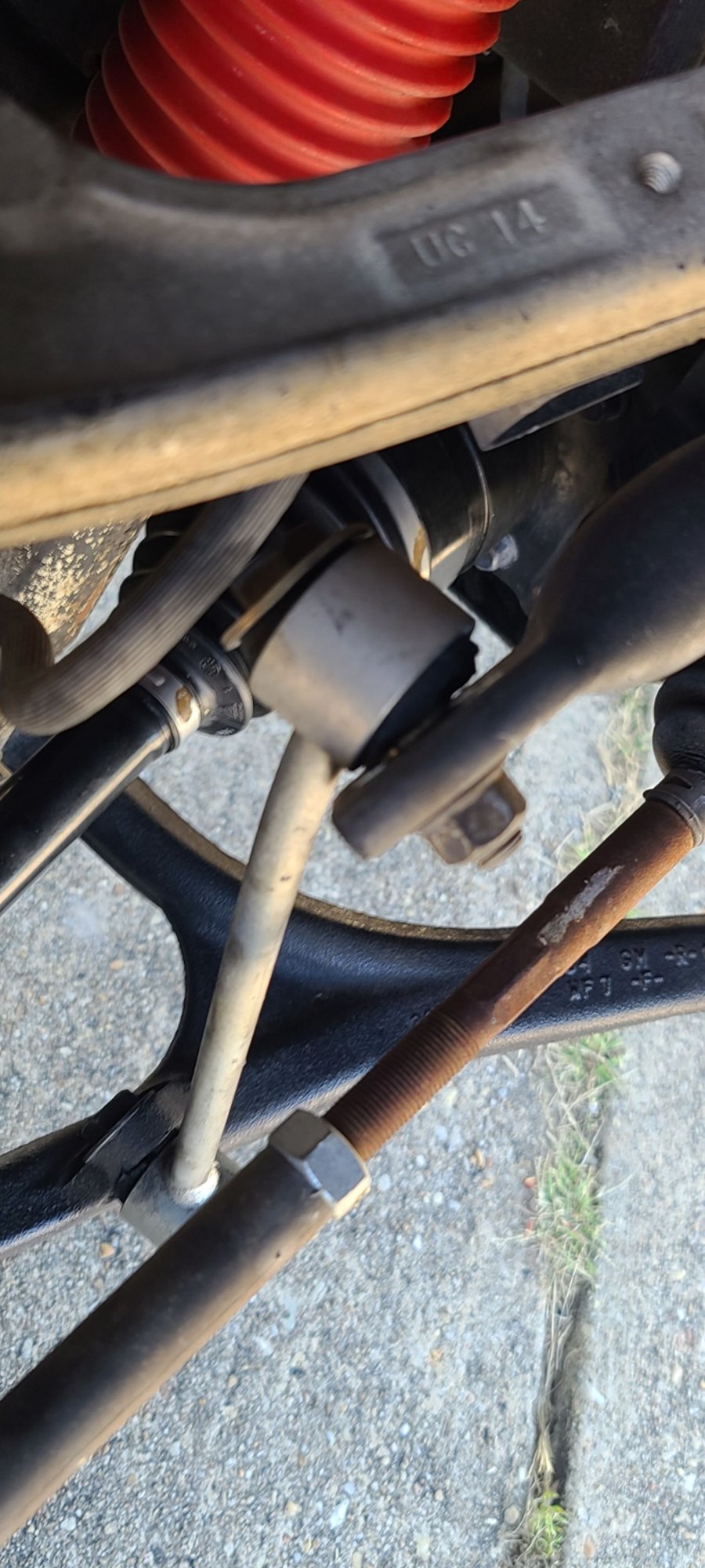

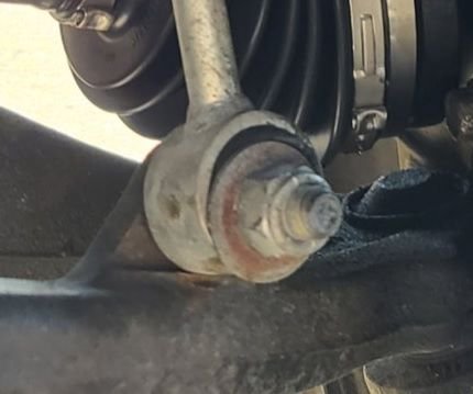

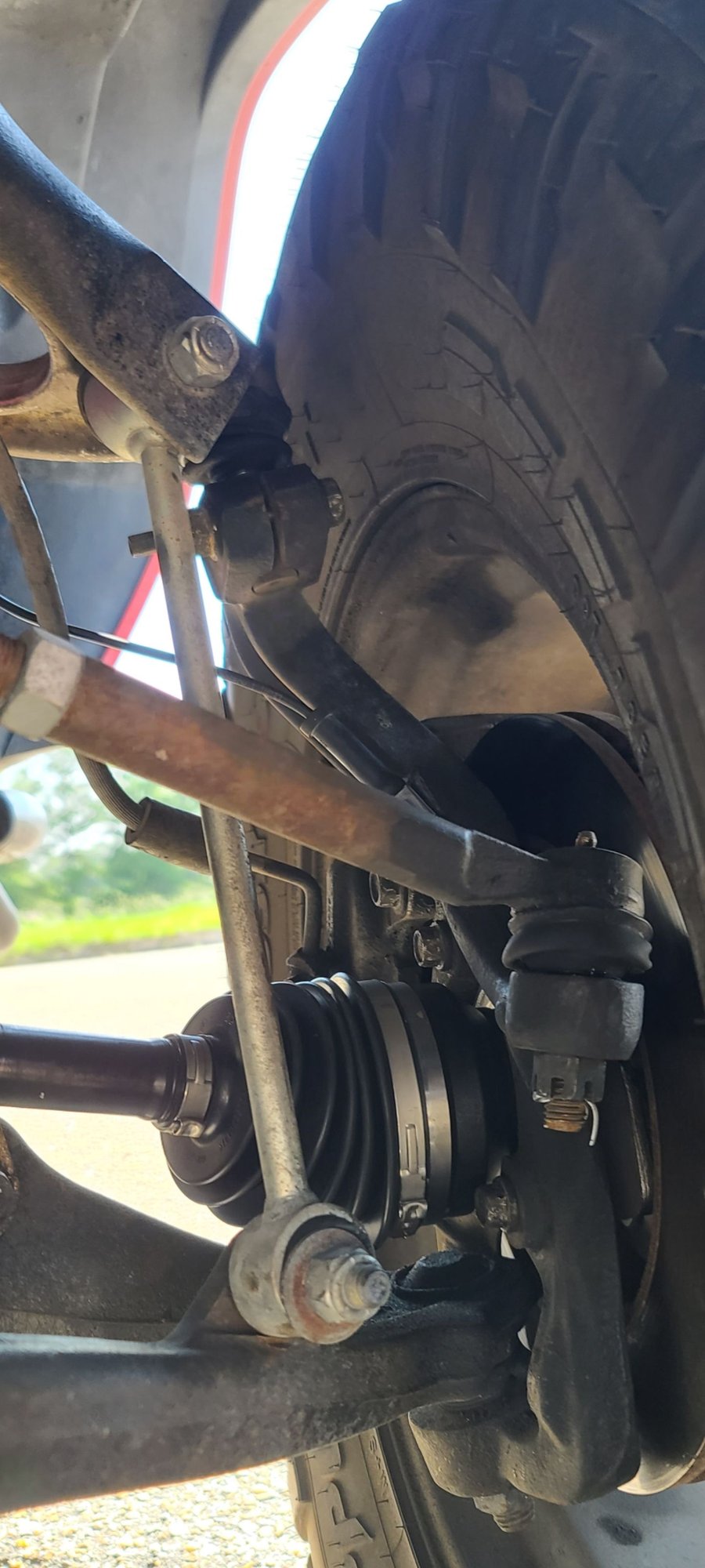

​​​​​​2009 Hummer H3T Adventure w/ 4-inch Rancho.
I have a single clunk/pop noise when turning right on uneven surfaces. I do not get this noise driving straight at all. Hopefully someone can pinpoint what this is before going to a shop. All pics where taken as soon as I heard it so my suspension is slightly flexed. Does anything look wonky/need to be replaced? Thanks for the help guys.

Remove the stab link & recheck.
Sweet, thanks for the response. Is there an upgraded version for the links? Which ones would you get? Is there additional stress on them because of the lift?
Did the noise go away? You can drive without them, just don't increase speed on road curves. Btw, those bolt through stab links are junk. Measure the length and buy ball/joint socket type:
