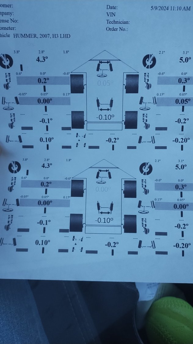

Thanks Doc! Read a few threads on the matter last night, cranked it back down to 23.5", ordered extended bump stops and went to get an alignment done this morning. Did they actually do anything? Lol

Did you pay them for that half azzed alignment?
