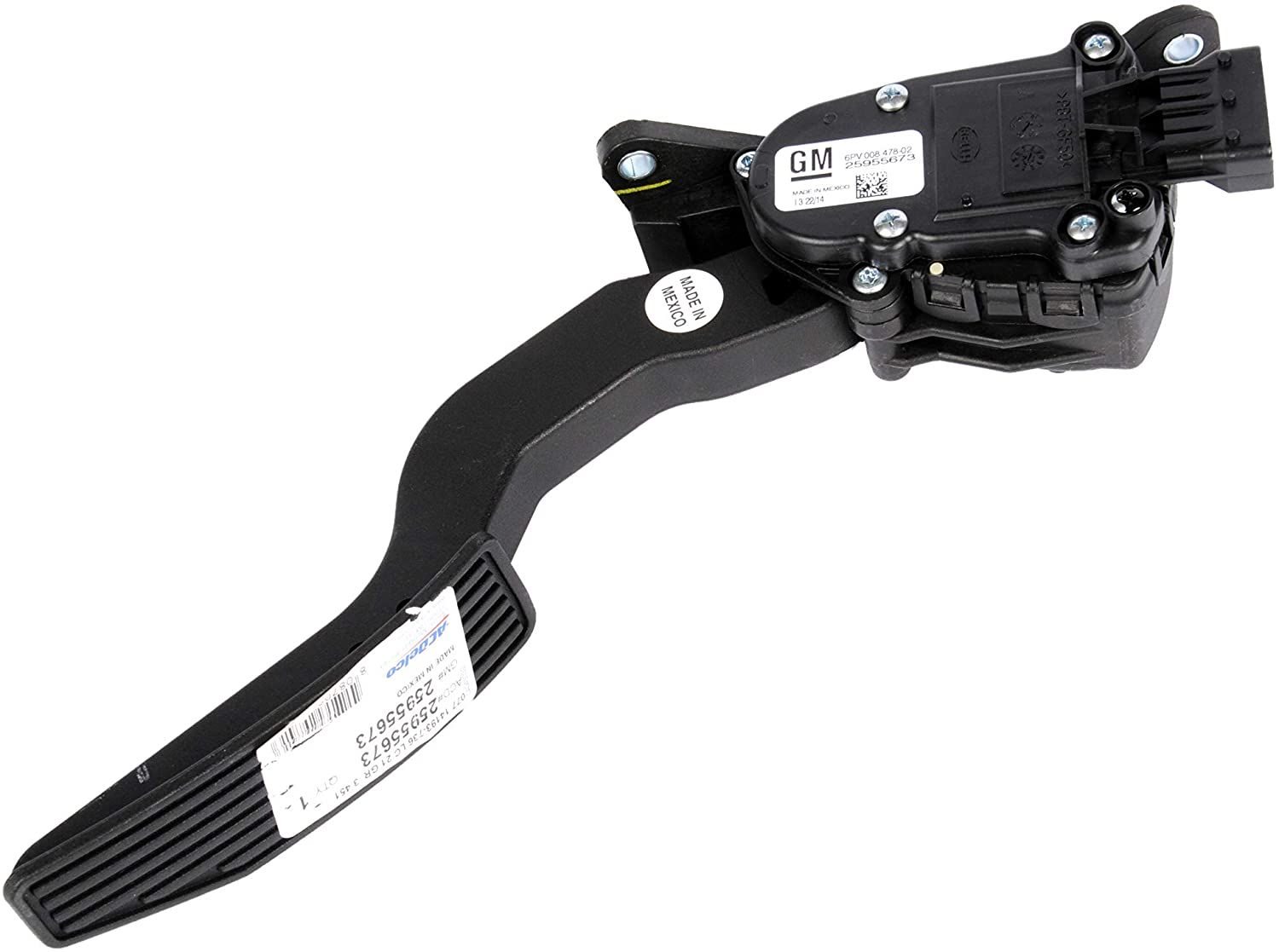

Doc, PPS is ?
Old Jun 18, 2021 | 06:55 PM
PPS(Pedal Positioning Sensor) APPS(Accelerator Pedal Positioning Sensor), PTS(Pedal Travel Sensor) = 25955673

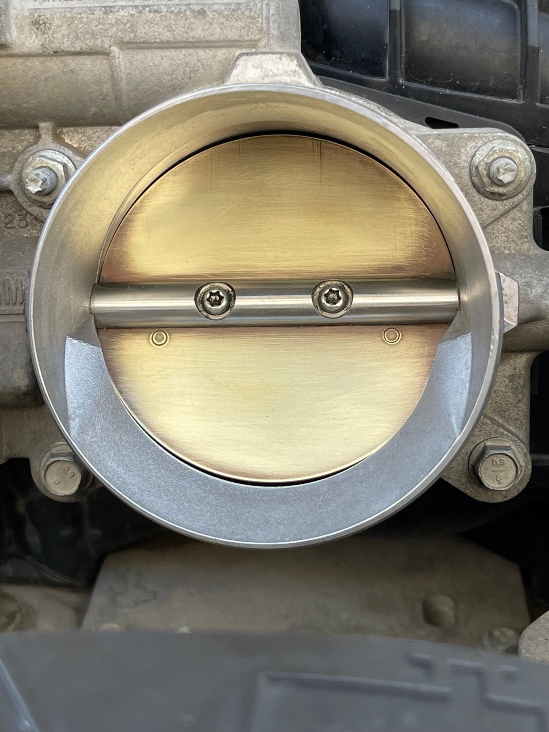

Post some before and after photos! I'm interested in what yours looks like.
Here's a video I made if you're interested in a visual guide:
Most throttle bodies can be cleaned this way I would disconnect the battery, anyway. Anytime I'm fiddling with electrical I disconnect it. I checked the 5.3L manual and did not see anything different in the removal procedure. The throttle body "relearn" should still be done, I think, especially if you clean a lot of gunk out of it.

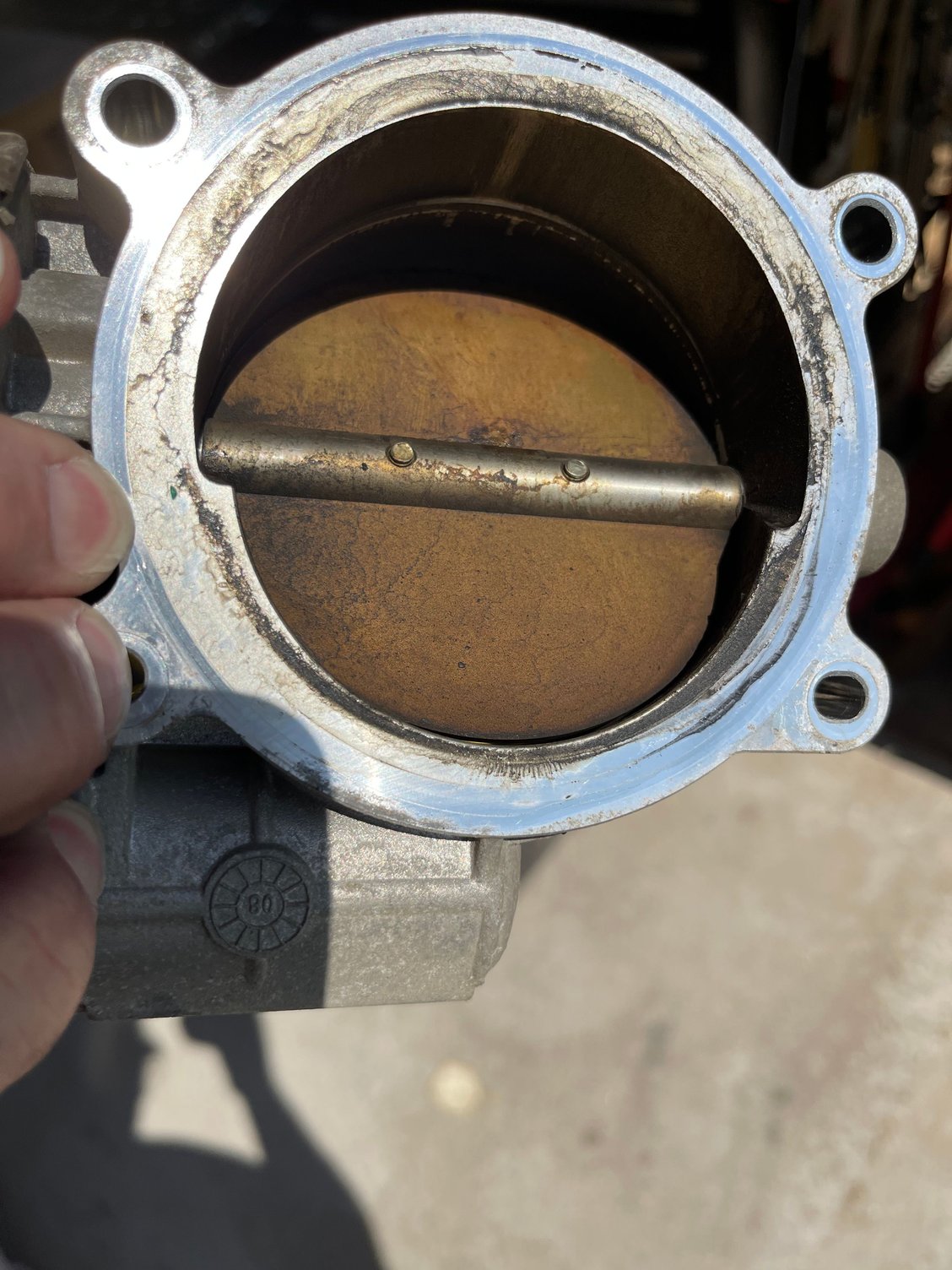

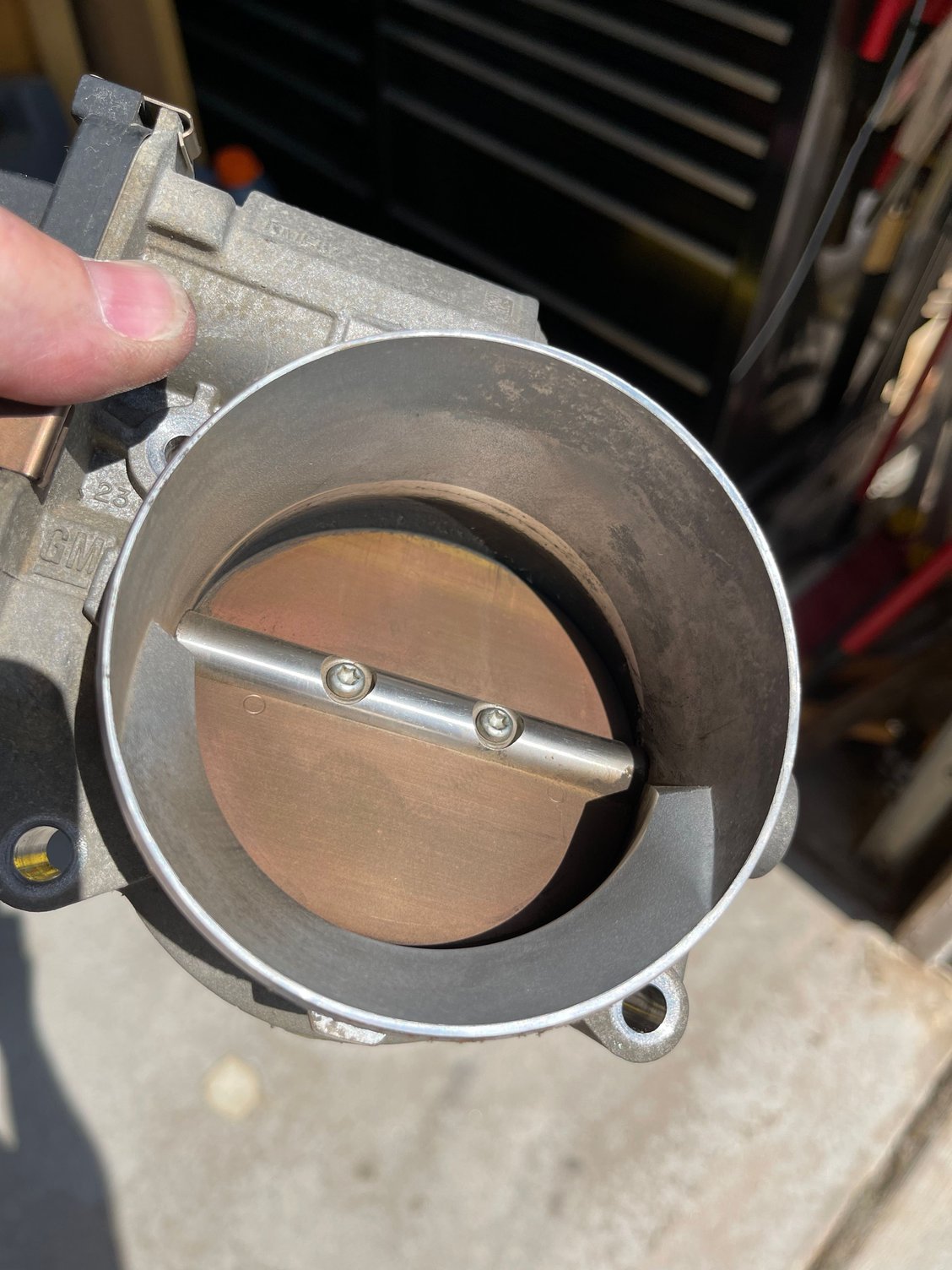

I completed the cleaning yesterday. All went smooth. I did similar to your relearn per-say. I started it and it ran smooth. Let it idle 3 minutes with no depress of the accelerator.
Before
Before
After

Looks good!
