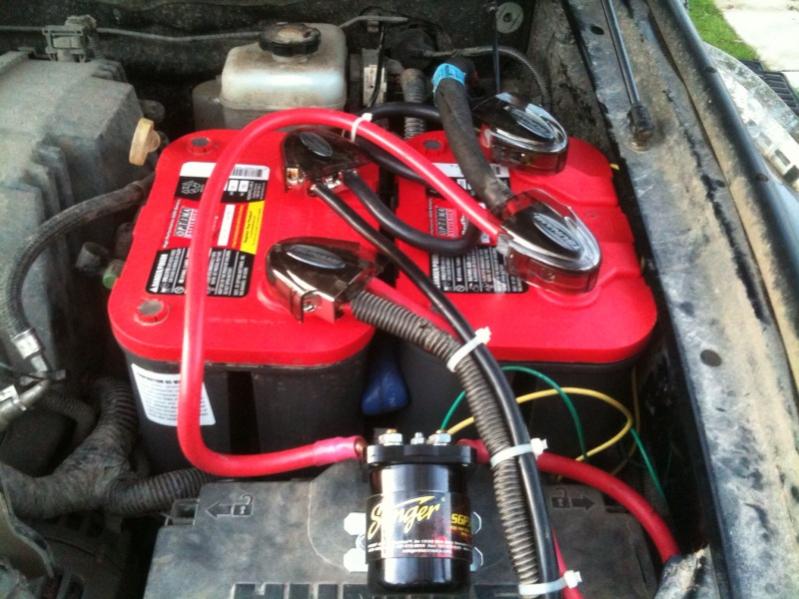

I would advise something in this nature to get you through these cold winter months

wow!
tell me about them?,,in what?
i like lots of batt power
will it fit h3?
and what is the hookup detail?, not just parallel is it? switch?
