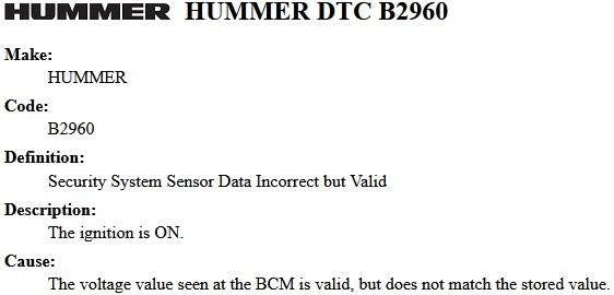

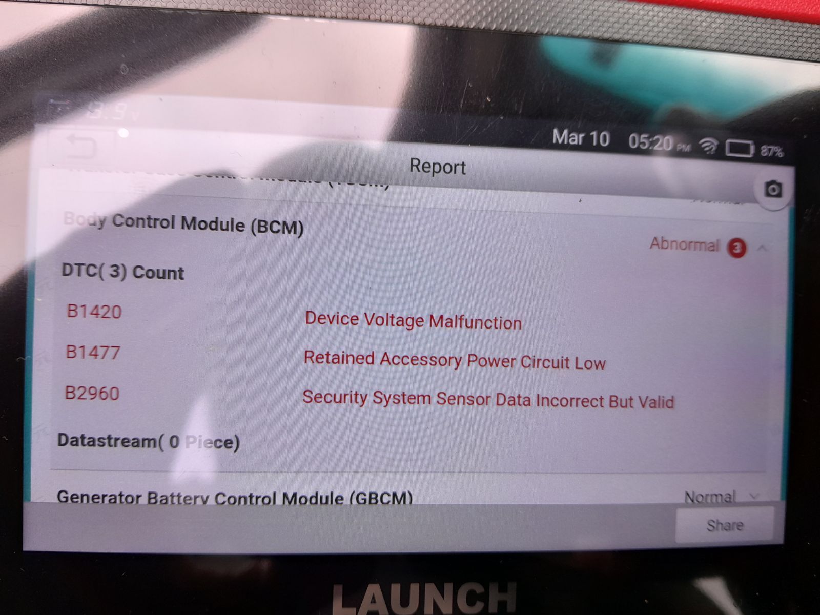

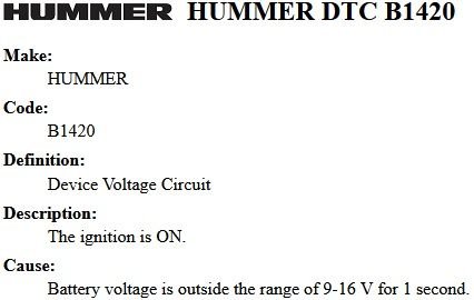

Old Mar 15, 2024 | 07:09 AM
battery is dead or dying and/or krappy azz OEM battery terminals.
Old Mar 15, 2024 | 09:48 AM
Those crappy azzed OEM Battery Terminals create all kinds of issues, but yet so simple to correct.
