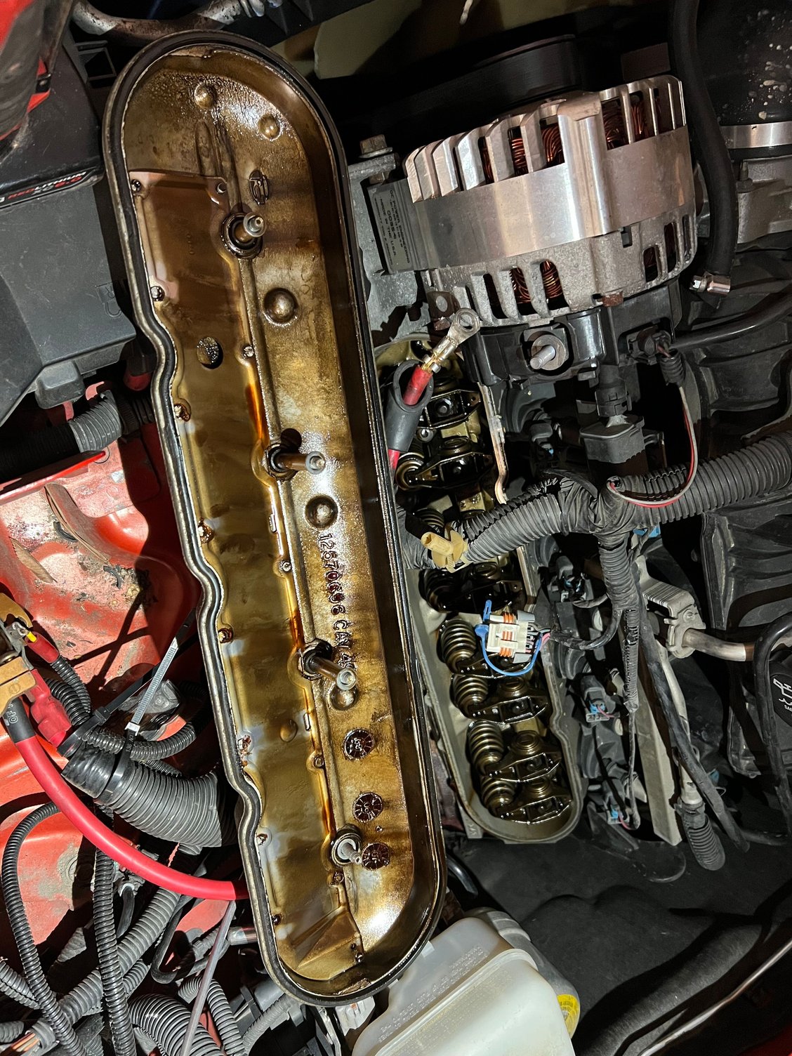

I changed the plugs in 2019 along with the coil packs then.
The valve covers were very much stuck on. I used a plastic trim pry bar and a mallet to wedge the covers off. The cover on driver side, which no coincidence i guess is bank 2 for the cylinders and cat, looked dirty in comparison to the passenger side.
Pretty sure the cat is bad, I had changed the sensor a year ago.
I
attached photos
Thank you and HUMMERZ both for your quick reply

130K ish miles on the odometer, Just changed the plugs, new valve covers with new grommets and gaskets, new pcv valve; didnt fix it. Still runs rough at idle, flashing CEL no code, rpm needle bounces.
First crank after doing all that work, the truck started worse and i smelled unburnt fuel and it threw a code: P0300. But then I found I had not reconnected the number 1 and 3 wire to the coils; I cleared the code.
Putting those wires on, truck ran rough then smoothed but didnt go back to how it should be and then the flashing CEL came back on,
I am pretty sure the coil packs are good. Im thinking a fuel injector is bad.
