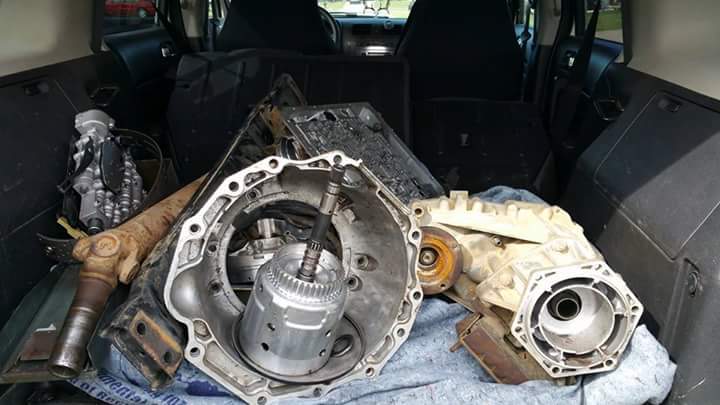

Old May 23, 2016 | 01:13 PM
rsc's Avatar
rsc
Joined: Jun 2010
Posts: 1,042
Originally Posted by Ordieh
The bell housing for the H3 trannys is not removable.........cast with the the main body!
I call BS, the bell housing is removable. It has to be to fit the Atlas motors on our vehicles. It also uses a weird size of torx bit to hold it on (in case you are swapping things). Ask me why I know.
