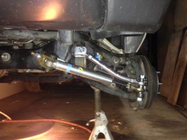

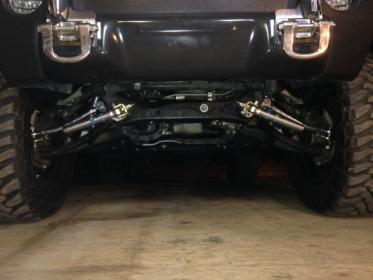

I've finally got everything going in, ended up replacing the Rack Bushings as there was a little play, but I don't think that was my issue, so I upgraded the Tie Rods with Bullet Proof Steering's units. Mainly because I wanted to do the Double Stack Tie-Rod, and Stabilizer.
Attached Thumbnails H3 Steering Stabilizer-stabilizer.jpg   H3 Steering Stabilizer-stabilizer1.jpg
Old Jul 19, 2014 | 10:47 PM
tome10's Avatar
Joined: Feb 2011
Posts: 23
Been about 6mos now, drives great no kick. It was a PIA to get Aligned because the Bullet Proof's 17 degree bend, you can't just turn the tie rod to align, it has to be disassembled. It took me a couple different alignment shops to finally get the alignment right.
