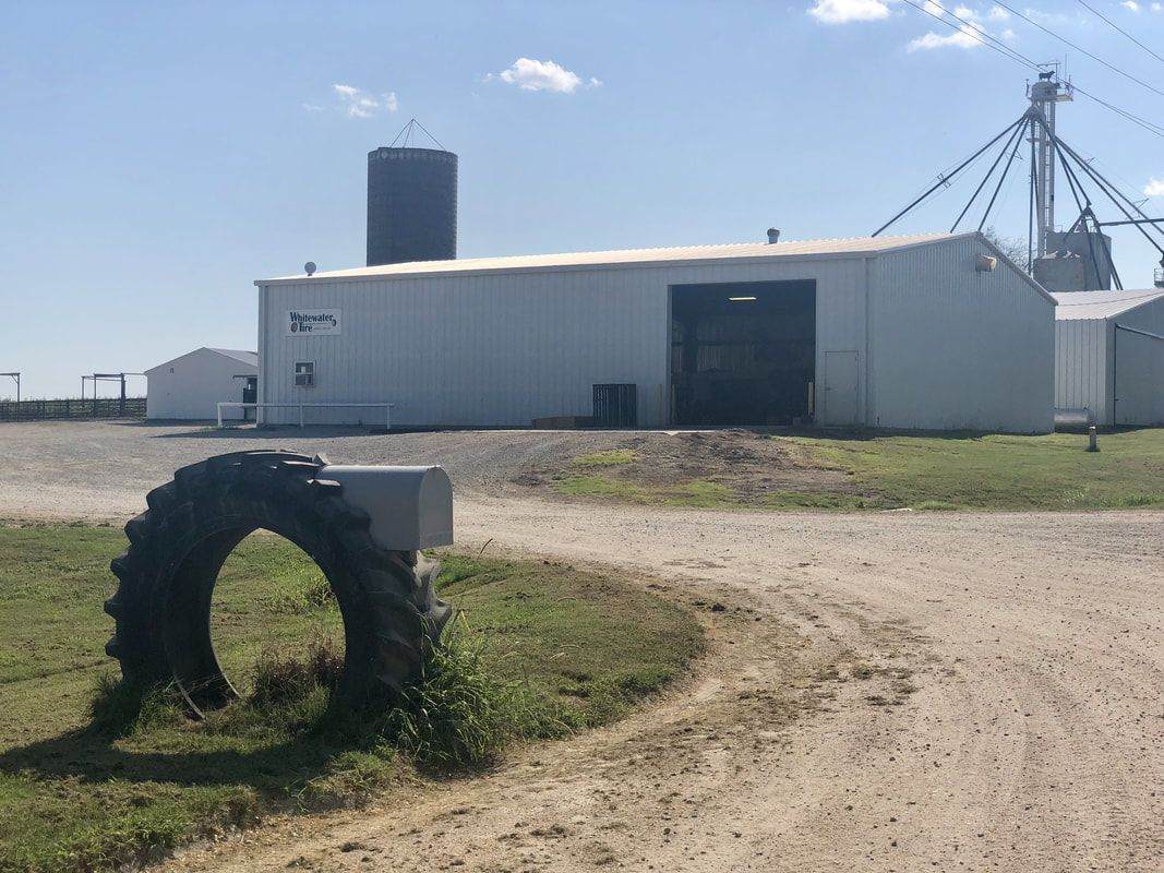

Old Sep 29, 2021 | 04:45 PM
You took your HUMMER to a farm with cow milkers, egg collectors, & butchers, on duty?
Old Sep 29, 2021 | 04:51 PM
"We Never Tire"...? Farming begins before sunrise!

And to all the 'farm' remarks , your comments are just trolling. Those comments are irrelevant to my question. Yes, I was born and raised in a farm community, where you won't find a harder working class of people.
No I didn't take them where they milk the cows and butcher them. They raise steers, not milking cows and the butcher is Whitewater Locker, owned by Scott Bowlin. But before you slam the working class, if you ate today. You better thank a farmer! My grandfather always said 'Don't bite the hand that feeds you!'
