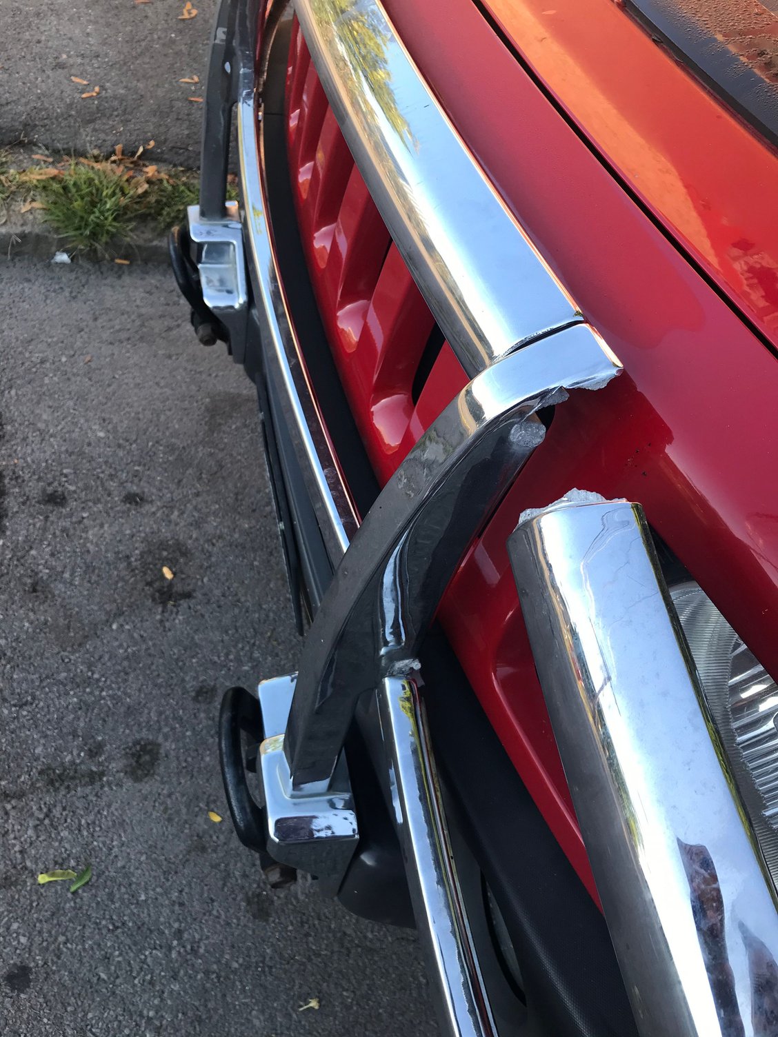

I have the piece, can it be welded back together?

Post clear picture(s) of your break.
Old Aug 30, 2020 | 07:40 PM
Posts: 3,204
it can probably be welded with some plastic but you will most likely have to sand the chrome and paint it with something afterwards

Default Pics attached
to original post
Old Aug 31, 2020 | 08:17 AM

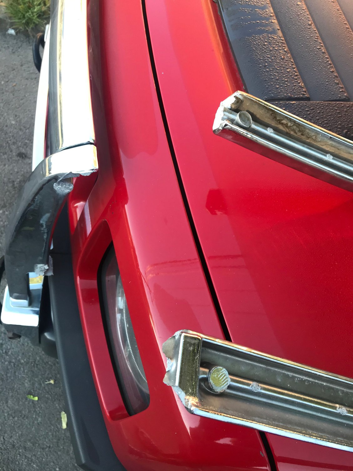

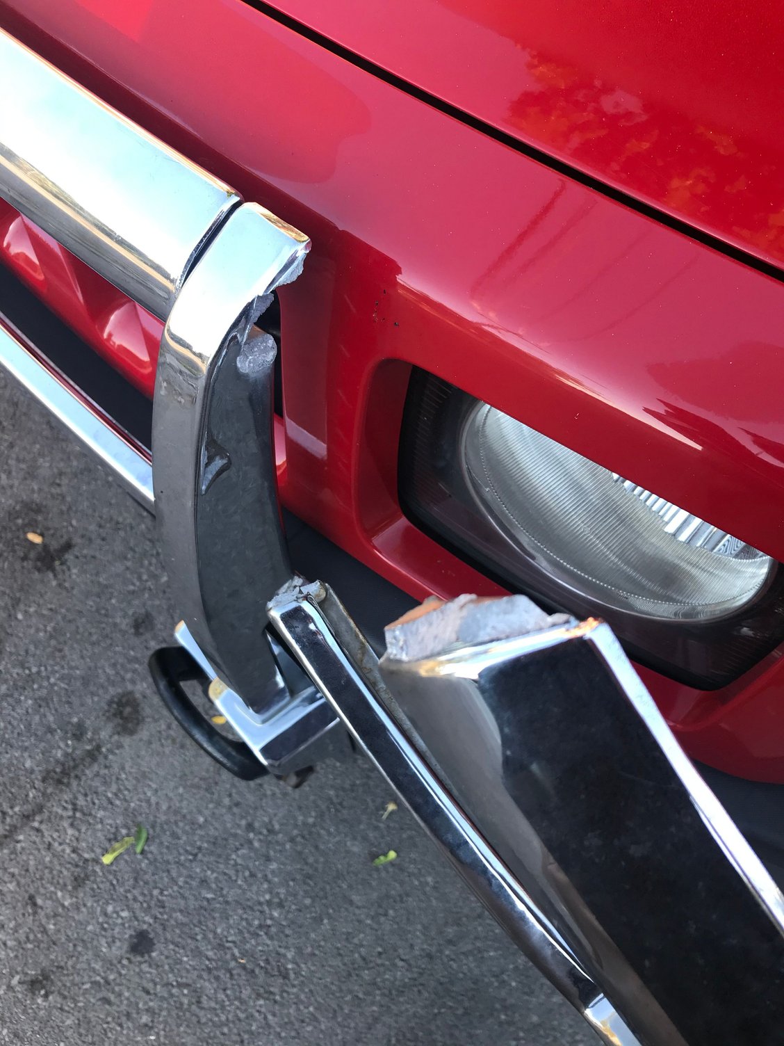

Super Alloy 1 Rod and Flux Repair Kit. Costly and no guarantee when diy, or can take to weld shop= more money. Cheaper to find a used one for sale... Btw, the brush guard can be taken apart, so if you can find 1 cheap that has damage to the opposite side and use the piece you need.
Old Aug 31, 2020 | 09:00 AM
Not guarding against brush when a twig can snap that cheap white metal.
Look at it this way, now is an opportunity to buy a real BG.
Old Aug 31, 2020 | 09:47 AM
X2 Lose the pot metal brushguard and buy a STEEL one.
Old Aug 31, 2020 | 03:28 PM
Posts: 3,204
ahh thats not the front grill... chop off the other side to match.

look like alloy. someone with tig would be able to help you, but your chome will be gone around the weld.
myself i have the guard made out of steel, powdercoated and all rusted. so i cut off the vertical studs, order new ones from laser cut- basically its deep custom... will be double 3/4" plates...and will weld back the horizontal part, sandblast it and probably will powdercoat the whole thing
