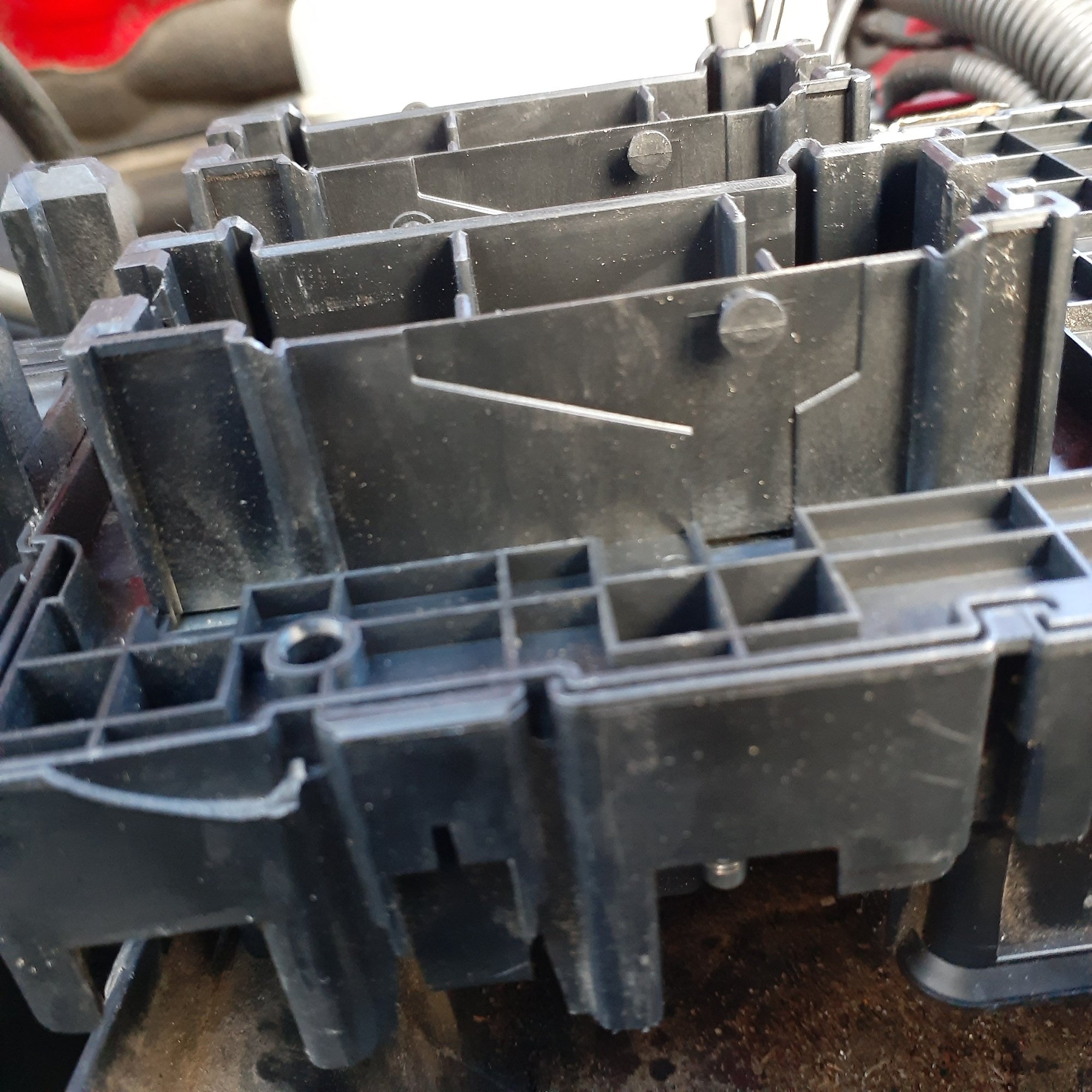

There is your problem, they should not be very difficult to snap into place. Take the fuse block back apart, closely inspect it on the underside and inspect the grey and white harness connectors. You may have bent a pin/pins when trying to put it back together. While doing all that, get some CRC Electrical Contact Cleaner and spray the block connection clean and let dry before another re-installation attempt.
If you see any bent pin, carefully straighten with a pick or super tiny screw driver.
I was going by what he said here:
"Once you get the alt in and start to put everything back together, there is one thing you need to do.
When you are putting the fuse box back together you MUST put the two wiring harnesses on the fuse box. They take some force(alot) to get them to clip in. If you try to put them in the base and then put the fuse box on, it wont snap into place.
These must snap in to the top first(where all the fuses are."
Having said that, i am going back in. Inspected the pins last time and they were all good(or seemed that way).

So after going back in and disc/reconnect the harness box, i now have power to the dash radio and dome lights. However, no power to the windows and when i turn the key it won't crank. I can here it click under the hood, but no crank. And the key still won't come out. Hoo boy this is fun....

Got it!
Went back at the fuse box for the 6th time with this statement in mind: "The fuse box is a pain in the *** if you didn't realize there are attachment levers that need to be pulled out from each side of the electrical connectors under the fuse box. I kept trying to push the fuse box in, and couldn't figure out why it wouldn't push back in. Move those levers on the grey and white connectors."
One or more of them must have been interfering with a full seat of the boxes. When i was tightening down the battery terminals i heard a *click* in the fuse box that i wasn't hearing before. With toes crossed i turned the key and BOOM...success.

  • The fuse box is a pain in the *** if you didn't realize there are attachment levers that need to be pulled out from each side of the electrical connectors under the fuse box. I kept trying to push the fuse box in, and couldn't figure out why it wouldn't push back in. Move those levers on the grey and white connectors.
Thanks again for posting this!!
Im stuck here as well. I can't get these plugs to snap back in. I'm push hard as heck and I'm getting the gap when I reconnect the box. Any more tips?

I got them in you really have push those bad boys in. Great post by the way.
