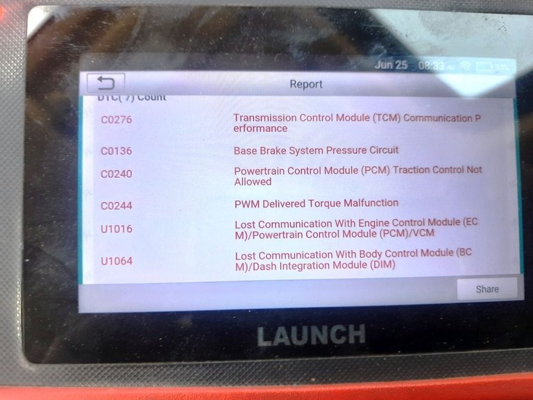

Hi folks, bought a 2007 hummer h3 3.7 last week with these issues. None of the 4wd lights turn on and just flashes once when trying to engage. The vehicle is in limp mode and takes a long time to pickup and start moving. Also unable to turn off headlights even with the key out and car locked. Please see attached OBD codes. Please help, don't know where to start. Thank you.

how bad is the battery and the battery terminals?

Well I bought a new battery yesterday, already has the upgraded terminals.

Do you have a sunroof? If so, has the passenger side floor been wet?

Great, now clear the codes & scan again. Post the current codes.
