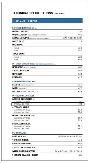

Per the Hummer brochures, the 08 Alpha OIffroad had 9.1" of ground clearance (which seems wrong to me, it should be 9.7") and the 2009 and 2010 Alpha Offroad had 10.5" of ground clearance on the same tires. I was not aware of a significant difference in suspension setup. These published numbers are a significant difference in clearance. Can someone explain the difference or am I missing something? If I can that much extra ground clearance by just buying a newer model I will. Was just curious before I drop the cash...

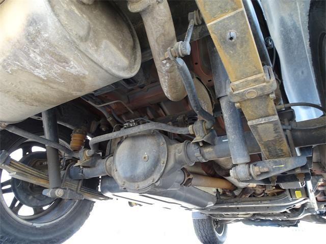

2006-2010 H3s are ALL the same. No super secret squirrel stuff going on. Alphas us a higher rated T Bar (I think it is like 100# +), Adventure/Off Road models came with beefier ACDelco shocks, none of which change ground clearance.
The distance from the ground to the bottom of the rear differential is a constant, larger diameter tires can change it.
08 Alpha Off Roads only had a rear locker, 9&10 added a front locker.

Which begs the question; which is the real ground clearance number, 9.1" or 10.5"? And where is that measured at; rear diff, front skid plate, ???
Old Feb 23, 2023 | 02:32 PM
Generally, I always thought it is measure at the lowest object not a tire.
Old Feb 23, 2023 | 03:13 PM
Lowest point front: skid plate, rear: shock/spring plates=9" with 33" tires. Rear diff ground clearance is 10".
