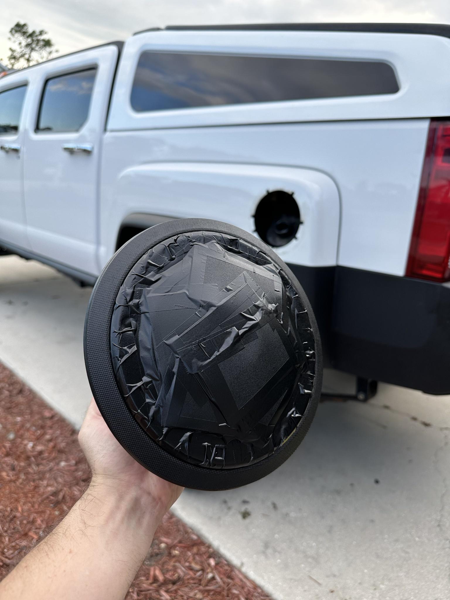

And plastic trim painted the fuel door bezel. Never did this when doing the rest of the truck, and it was starting to look faded from the sun.

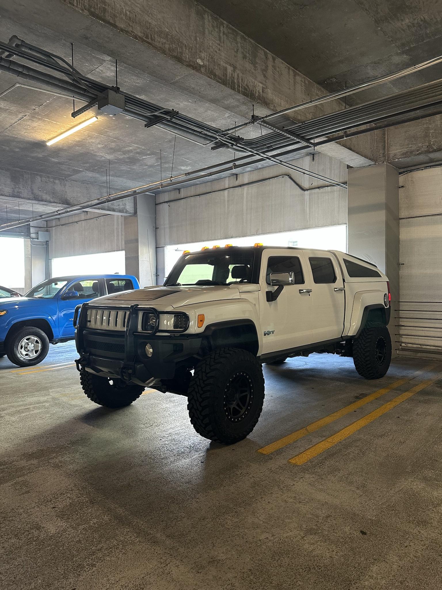

Took the truck to downtown Tampa and there's no damn place to park, except for the parking garages. Luckily she still fits in there, and looks damn good.

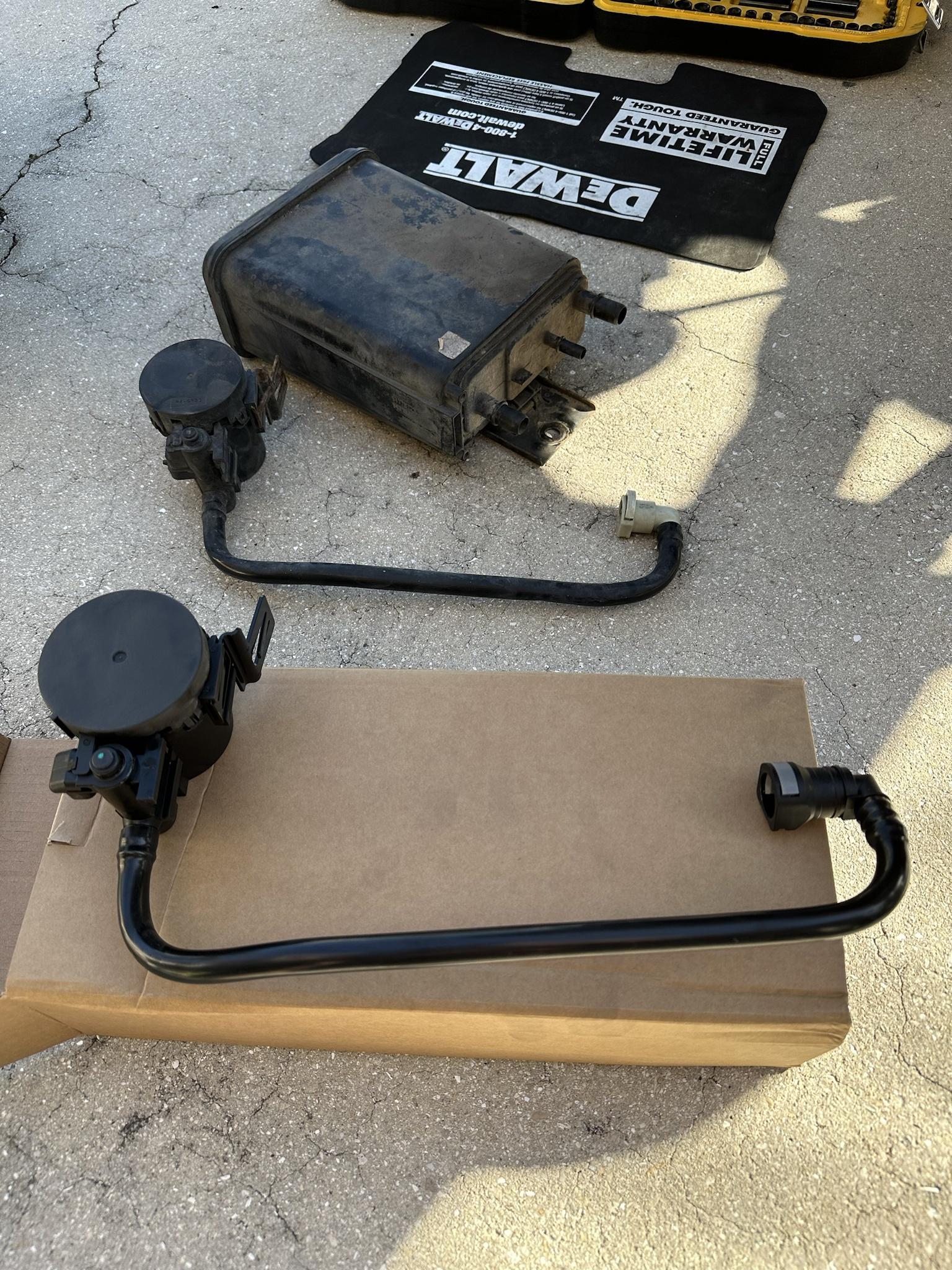

Couple of months ago I got a random P0449 code triggering the Check Engine light. Cleared it and it went away for a week. Then it came back and never went away lol.
After some research and clearing the lines in the rear, I found it extremely hard to believe that it was the eval vent canister, so I bought a cheap one just to see if that was the issue. Like I said, I found it hard to believe this would be the issue since it's just a tube, canister and a simple electronic so this was just a gamble purchase to verify.
So back under the truck I go to pull the charcoal canister and vent canister... Old vs new.
New vent canister on charcoal box.
When pulling the old vent canister, I took off lid off the top and peered inside. Seemed pretty empty and line seemed to still be clear as from before when I checked. But I turned it upside down and tapped down on it and dust/sediment/charcoal started to fall out. Tapped it a bit harder and I started to see the caked layers and dust of what I'm just going to call charcoal come out. After re-installing everything, fired it up and no codes now for a month. I am wondering if the old stocker would have still worked if I just cleared out the debris clogging it. Who knows...

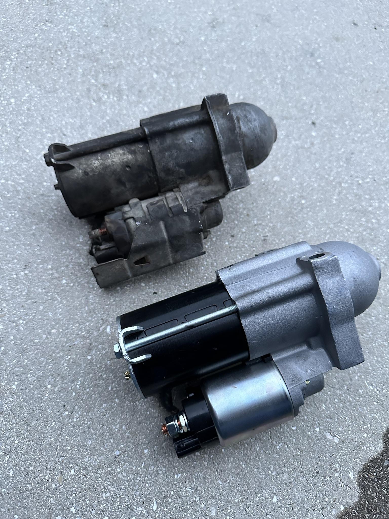

And then started to notice that the T would start just fine while cold, but was slow to start when warm. Wasn't a battery issue since voltage is fine and have plenty of capacity now with the dual battery setup. Ordered up a new starter and replaced.
Old vs. new.
Turned out to be the winning ticket. Starts like new again, and no more slow starts when warm.
