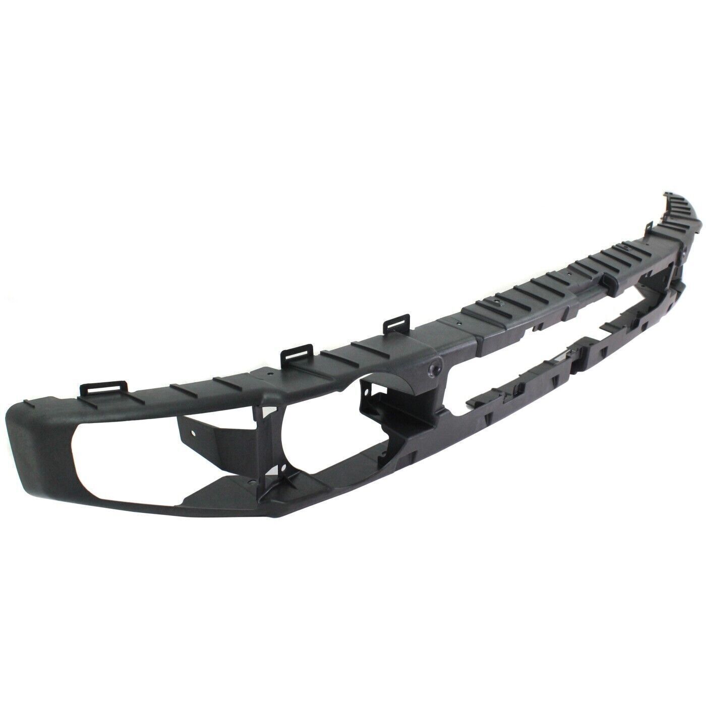

They even said the 2009 front bumper filler doesn't fit the 2010, but I got it anyways (yet to see if there is a problem).
Old Mar 13, 2024 | 08:54 AM
Yeah, never assume any GM Dealer knows their azz from a fence post, let alone is an "expert" in GM parts.
The bumper fillers are all the same 06-10, here is a pic. I replaced mine on my 07 years ago, then swapped the cover from my 09 onto the filler and bumper parts to my 07 when I sold it.
I replaced the passenger side inner fender on that 07 as well, easy job. I never had a 10, never replaced the driver side, but I am 99.5% sure the inner fender liners will fit all years. What I think happened is they changed the shape of the liner up by the bumper (the front edge may be longer/lower), but they change NOTHING on the truck that the liners attach to so it will fit no problem.
