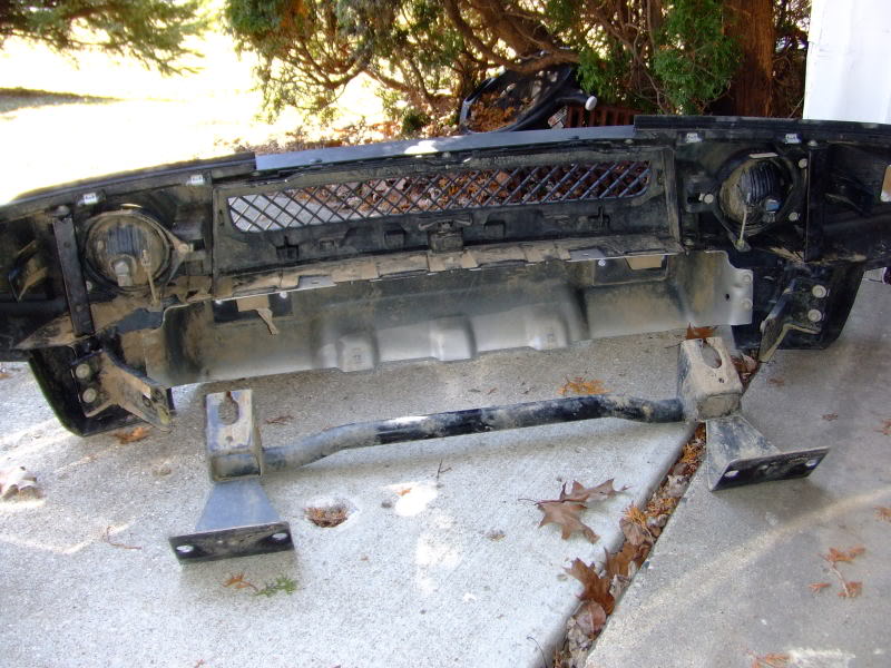

Wondering if anyone has found a front-hitch mount for newer H3's? Looking to install one for a winch mount, I see that CURT hitches makes one but it states it's only for 2007 or earlier H3's? Wondering if anyone has found one for a 2009?

Any front hitch for 06/07s will work. 08+ H3s have an additional impact bar that was not present with the earlier H3s. Remove the impact bar (the hitch will then be the impact bar), and you are good to go.
Circled in red, courtesy of Tainter.
Laying on the ground.

Thanks for the explanation and the pics!
