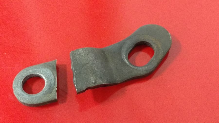

If you have the I5, look for this bracket on the passenger side. One side is attached to the exhaust manifold, the other end is mounted to the bell housing of the transmission. Mine was broken and I chased my tail around in circles trying to find the source of the noise - it was exactly as you describe. I only found it when I was pulling the transmission to replace the balance shaft chain, guide and tensioner. You can see the polished area on the edge where it was rubbing. Going from the horrible grinding noise from the chain and the groaning vibration from the broken bracket to a nice, quiet vehicle was heaven. The GM part number is 12622333, I paid $9.11 for it.
I do have an I5. Omg I don’t think I ever saw that part before! Thank you so much! Now I gotta try to check it tomorrow.

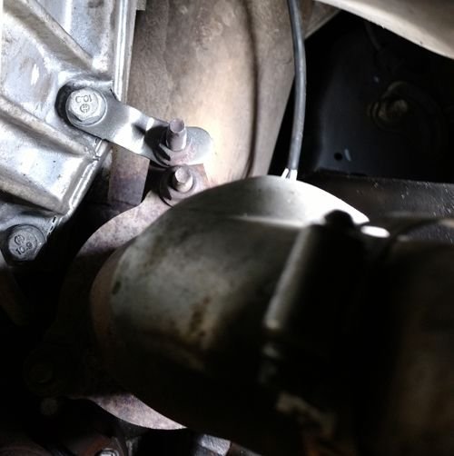

Old Oct 27, 2018 | 06:14 AM
DJB's Avatar
DJB
Joined: Sep 2018
Posts: 23
From: Traverse City MI
I had it up on the hoist yesterday, so I took a picture of what it looks like installed. That stud is in the exhaust manifold flange.
