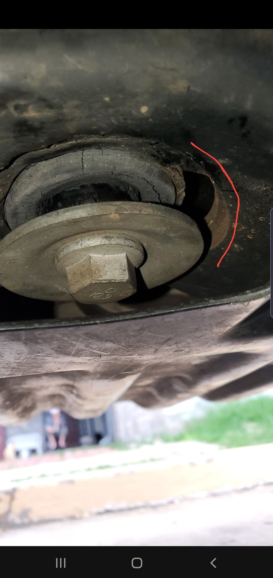

Old Jun 13, 2019 | 07:51 PM
usvet28's Avatar
Joined: Dec 2018
Posts: 9
my front support also has a gap where the bushing goes. I am wondering if i need a whole new crossmember ? or if i can still press a bushing into it
or if i can still press a bushing into it?
