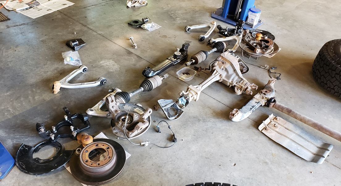

This is a photo of a cast iron diff from our T when I was rebuilding the entire front end.
Old Jan 22, 2020 | 12:20 PM
LatvjuAvs's Avatar
Joined: Feb 2019
Posts: 115
Thanks!
That makes all the difference, fairly easy to spot now.
