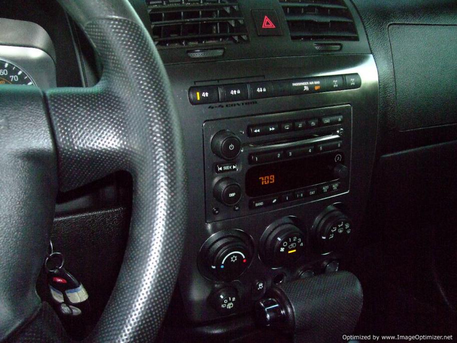

I've been out looking at Range Rovers and H3's of the '03-'06 and '06-'09 range respectively and have finally come to the conclusion that with children still in college, as much as I love the Range Rovers (and the H1's), our budget isn't quite ready to handle the things that I would not be able to resolve myself (programming electricals etc.) on the Rover.
So, I'm now serious about the H3 but I do have one question that most of the salespeople I've spoken with are unable to answer...or at least I'm not confident with their answers. The drive buttons, those to the right of the passenger air-bag control, what are the options there? I'm seeing some with only 1 button that appears to be traction control. Then I'm seeing other models with two buttons and what appear to be the front wheels turned?
Can someone provide a quick concise run-down of the options and the respective buttons...so I know what I'm looking at this weekend while I'm out test-driving some used H3's?

Early h3 rear locking diff. Later h3 rear n front lockers

What you need to know is that if there are two buttons on the upper right side of the center console (traction control on/off and 4 Lo Lock) then you are looking at the Adventure model. It has a lower xfer case ratio and front lockers as well as stiffer shocks (slightly longer too?) and the underbody skid protection. Oh yeah, tires are 33's as well (spare should be as well and if not covered by a tire cover it might be a tip off that it came as an Adventure or not depending on which tire is on there if not already swapped out when the original tires were changed out).

those 2 mean u have front and rear locker differentials, a very good feature,,that you may use rarely.
they work only in low lock mode so just verify that they are ok, then verify that hi lock is ok, then stay in hi,the first,left button.

Thanx for the replies everyone. I was wondering what the two buttons shown in this photo were...and why I was not seeing these in most of the rigs I was looking at. Thanx for the info everyone.

That's the '09/'10 Adventure package switches - one for front locker, one for rear locker. Notice the stability system button is moved down to the bottom of the center console.
All models have the same 4wd options and traction control, so every model is going to be pretty decent offroad, but Like Dirt Junkie says, if you plan to wheel it you probably want to get the Adventure package.
