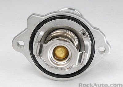

Here it is fail-safe 180 thermostat for hummer h3
Putting it in on weekend
Failsafe thermastat for hummer h3

Looks interesting. How hard is the install on a thermostat on the H3?
Is that for a I5 engine?
Thanks.

Made my own integrated thermostat housing for I 5 engine, tig welded 180 fail-safe thermostat #7203-180 to dodge water outlet #902-318. You could have just atv cemented the thermostat to a gasket with under size hole in center it fits into the housing so well it flushes out with the flange. Since I had access to tig welder it was nicer to just tack welded it together. My 2007 truck has original hard to get 180 thermostat working fine but it's old. Truck runs at 190 degrees according to tech 2. At only 40000 miles both front wheel bearings were starting to go needed to grease them Thu abs sensor holes to stop them from failing. Don't trust anything on this truck that's getting old GM has taken the time to figure how to make things fail after awhile. That... 113 thermostat is a ticking time bomb. Have to peel off drivers side fender lining to access thermostat looks like a **** off. Rather tackle it at my leisure than wait for it to fail and get stuck along highway. Have put Holden lions on hummer steering wheel and front and back Aussie GMC my hummer Australia GM is Holden.

GL trying to get that to seal.

To many issues with your post and I cut to deal with this part, and I can only hope that nobody takes your advice!!!!:
#1- It's your Father's Truck! (why are you destroying it?)
#2-OEM thermostat is 195 degrees
#3-You will not be able to properly seal the thermostat housing, when you weld the thermostat to the housing
#4-You weakened the thermostat housing by welding it causing distressed points to the housing.
#5-Replacing the thermostat may be a difficult task to you, however you will also have to replace the coolant each time to try to seal, that "contraption". Plus,if your weld breaks loose and travels through the coolant system, causing blockage in the coolant system, you will eventually overheat and cause engine damage.
#6-"Failsafe" thermostats are a scam!
The thermostat on your Father's truck is running cold,("truck runs at 190 degrees"), due to the fact that it's stuck open!
Yes, that is correct, the thermostat fails in the open position!
I had to replace my t-stat a few years ago, not because it overheated, because the engine temp was to low!
