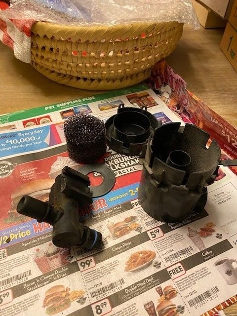

here is it taken apart because i wonder what the hell a $30 dollar part looks like inside

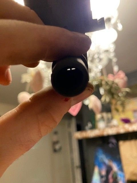

here is the reason i believe it was still leaking even tho i didn't have a code. not sure but this is open and its been replaced before on my H3

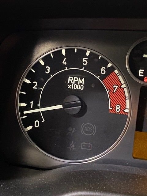

then here is where my idle is sitting at stop signs. not sure if its correct but i am assuming because the h3 is keeping it there it is correct. No more shaking!!!!!!!
