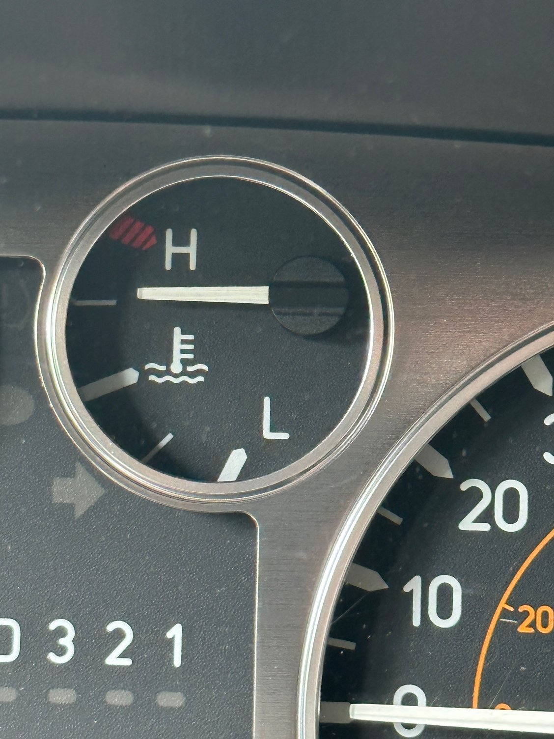

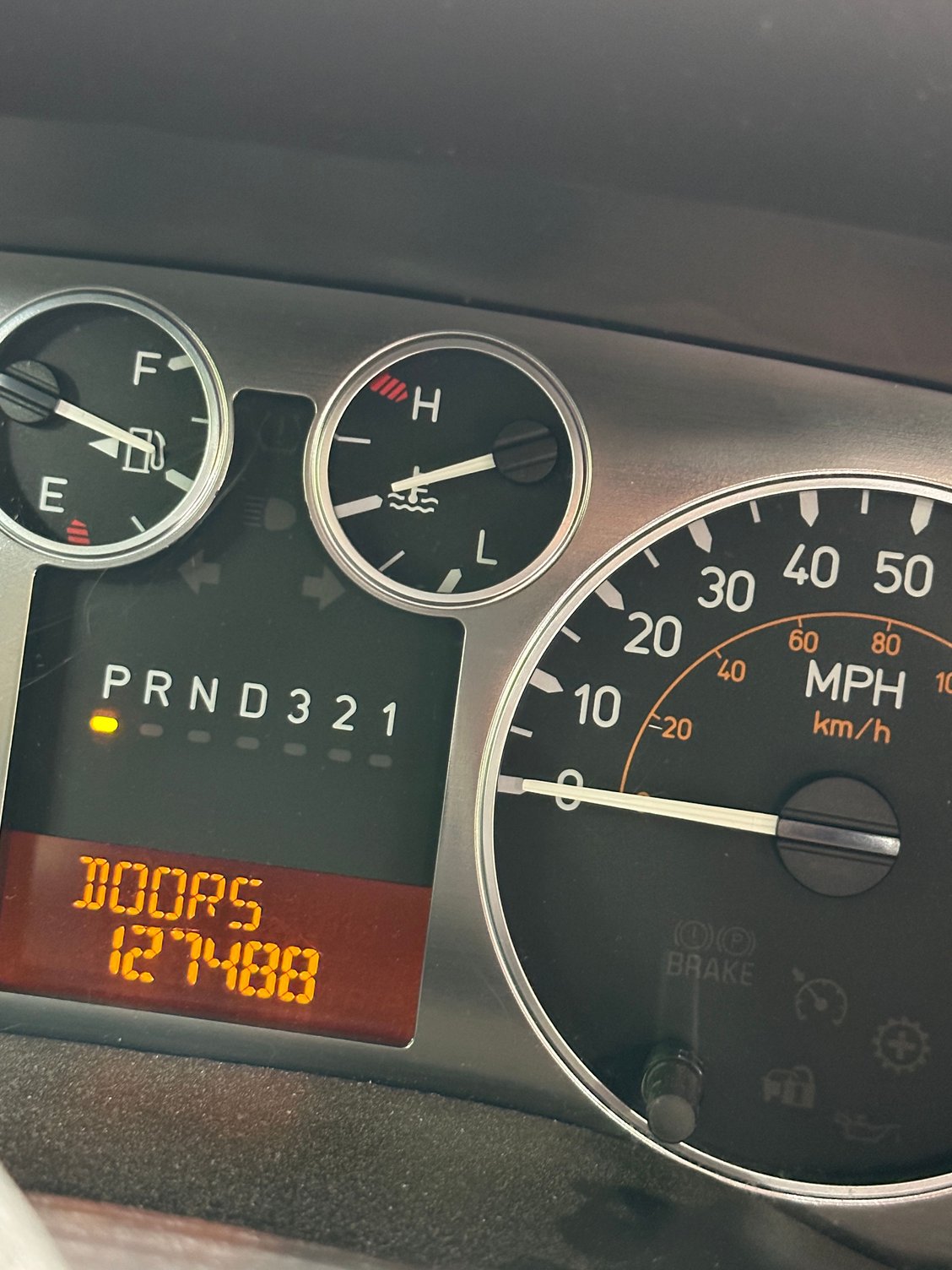

So this is been a long road. This is what your h3 temp should be at. In order to achieve this. I replaced water pump, thermostat and temperature sensor. Also have 1 royal purple ice. since I also have new water pump i also added a new tensioner, power steering pump and pulley and belt.
H3 after everything is fixed
H3 heating issues

The normal temperature should be below the average mark. This is the way it is for all cars. If the arrow is higher, then the car is heating up a lot.

Looks good.
thanks was a little bit lower today actually. overflow was a little empty

What temperature were you running before you did all that? What do you think fixed it or did you just replace all the stuff at once?
Old Jul 3, 2023 | 02:20 AM
Eurynomestolas's Avatar
Joined: Oct 2019
Posts: 150
I honestly dont know. I just like throwing parts and money until it works. 🤣 If its easy enough for me to do and i can get the parts off rock auto cheap. I just figured the h3 is running hot. I replaced thermostat with no change. so what else… water pump. which i was spinning the old one with the belt off and it was making some squeaky noise. so replaced it. I was also having some noise coming from the front @hummerz suggested take the belt off and see if it makes a difference. I just decided to replace the belt and tensioner and pulley. This time i went AC delco on those parts and my power steering pump was making some noise so i was like might as well flush the fluid and i already added new tensioner and pulley might as well add a new power steering pump with pulley. I threw so much money at this vehicle. i am like what else can go wrong. 😵‍💫
