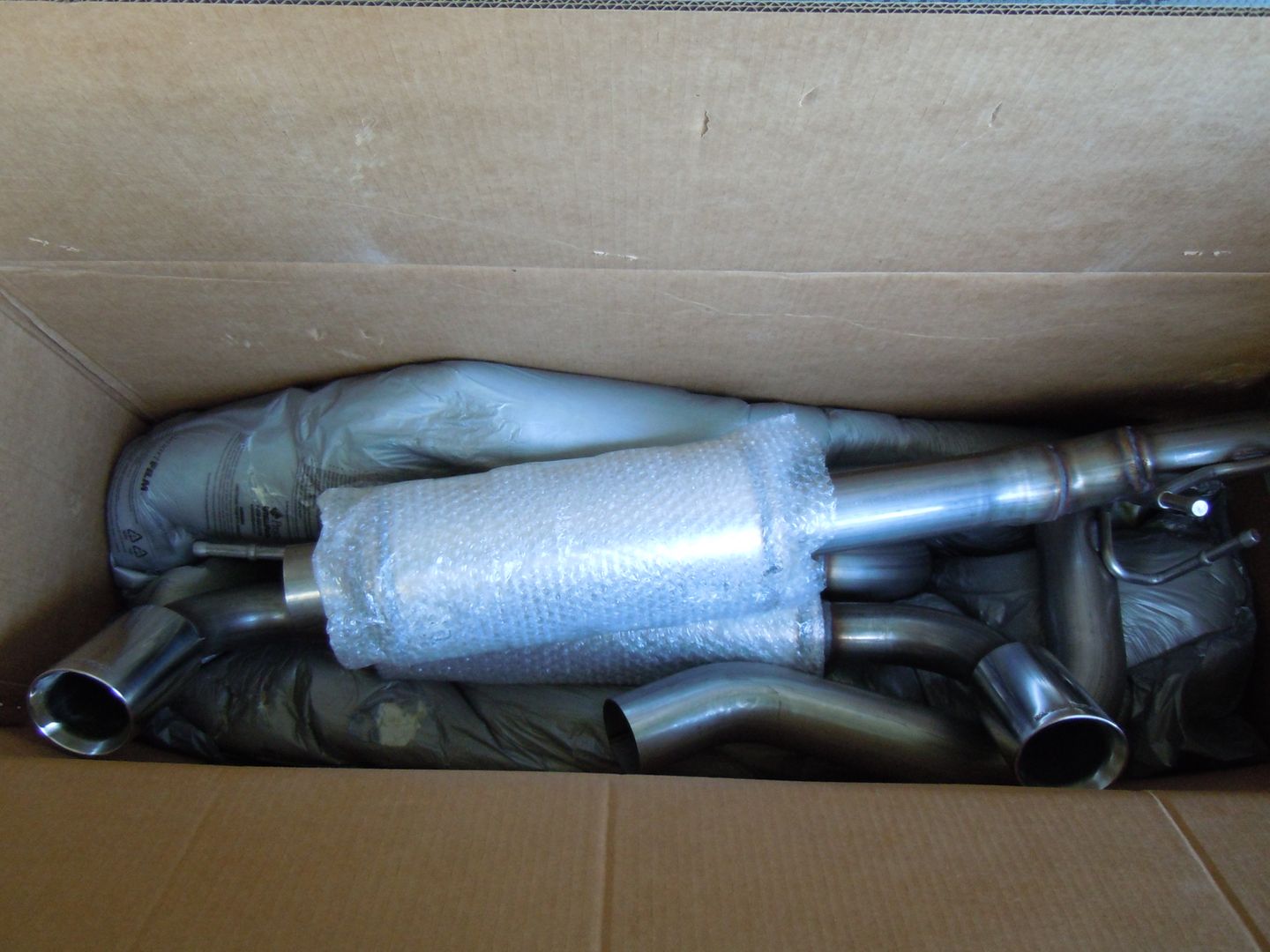

Update pics.... first is like the opposite of Chubs' pic.... the new MagnaFlow in the box.

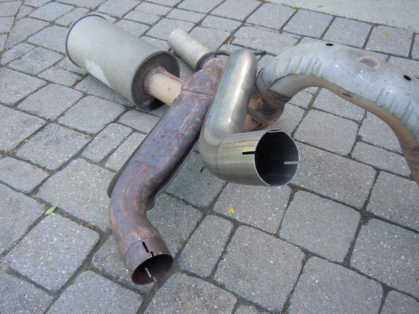

The second is a pic of the old system trying to spotlight the driver side crushed pipe that is replaced by the nice fully round MagnaFlow pipe that is set on top.

Best bang for the buck is a MAGNAFLOW CATBACK. The thing that helps most is that it replaces the restrictive “flattened” stock crossover under the transfer case. That alone is worth measurable hp in addition to 3” diameter from the collector, the zero restriction resonator and well designed muffler. Because the full diameter crossover is closer to the transfer case tailpiece, not a bad idea to wrap it in header shield held in place with stainless zip ties.
