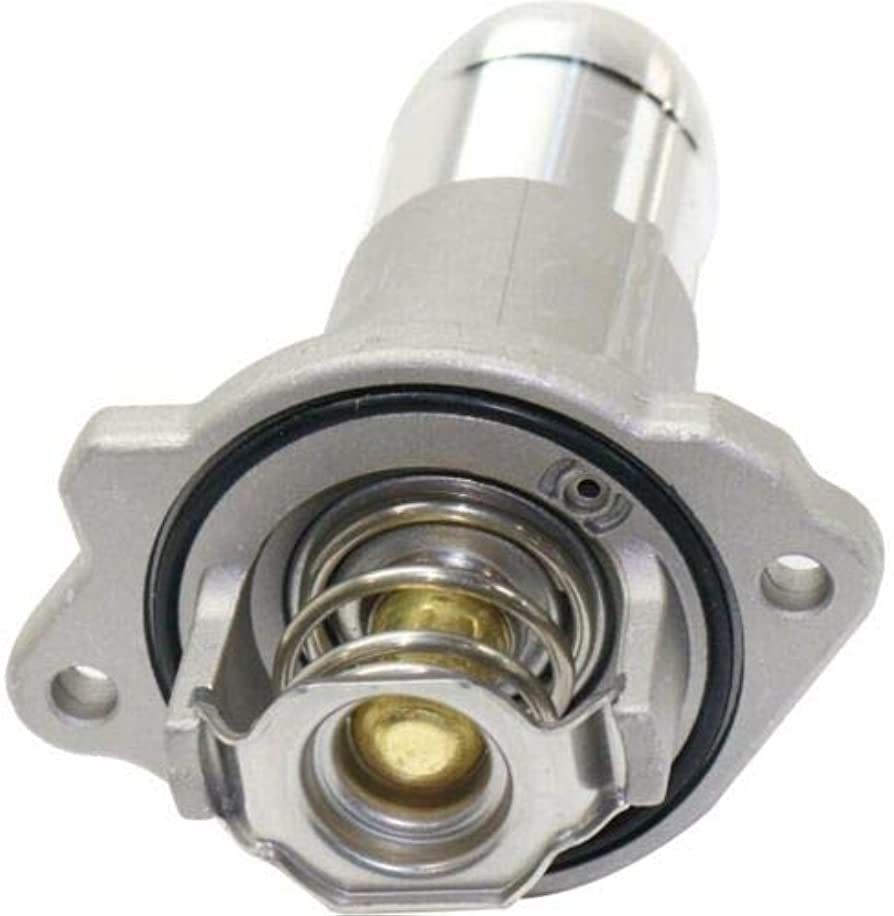

Old Feb 19, 2023 | 12:18 PM
Posts: 9,018
Install a thermostat, oem stays closed until 187°F (86℃).
Yes this is a potential option, but will need to drill some holes in it regardless so that there is some flow through the engine until thermostat opens, as the ewp is on the radiator outlet. I may well go down this route. The main concern Im have is I'm not sure if having the EWP pushing against a closed thermostat would be detrimental to its lifespan or if it will be fine...
