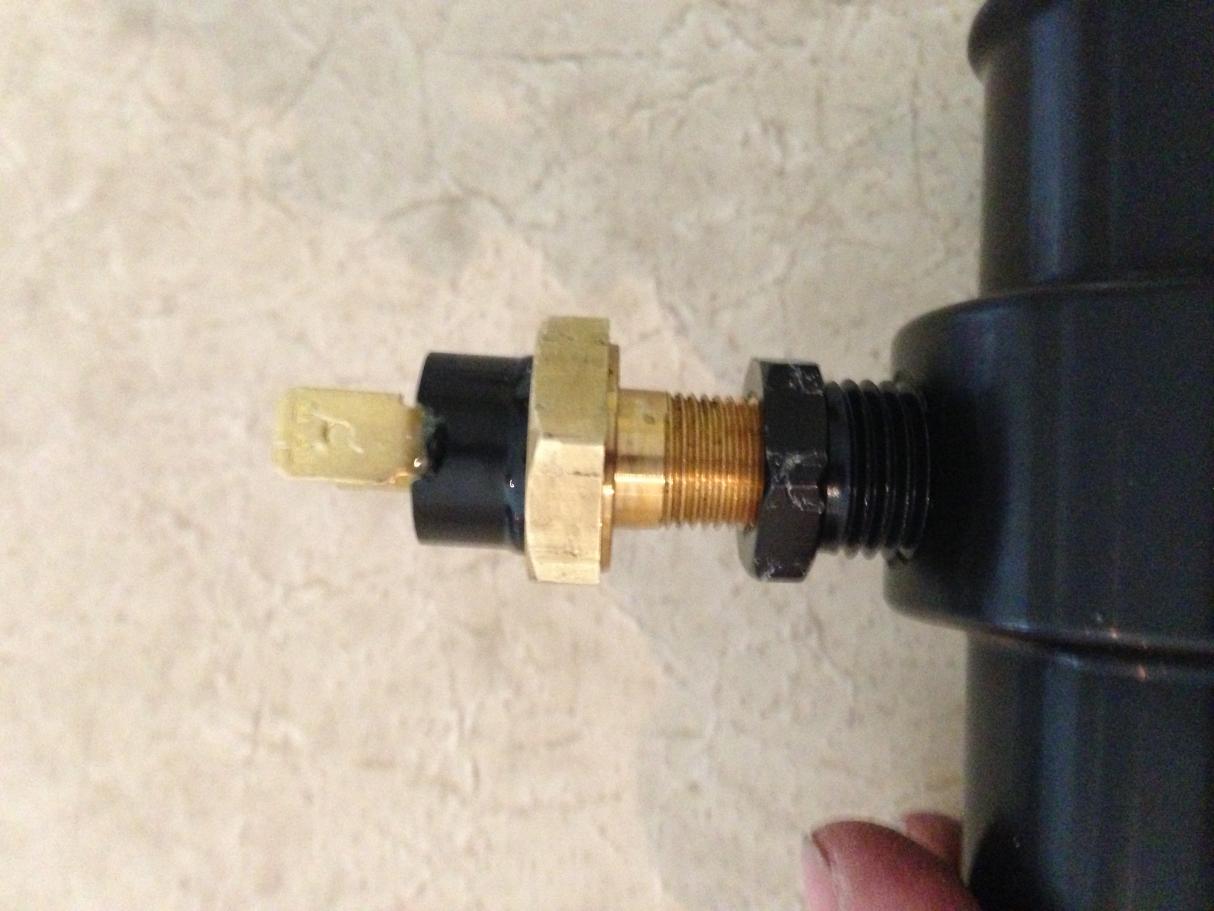

ok I have double checked the connections. Everything seems to be right! I wonder why I am getting a surge.. Here are some pictures! Also does your temp sensor look like the one in the picture? I called PCM4Less and said that was fine.

Good news is everything is working!! I was degreasing my power steering pump and then washed it down. Guess I got something wet. The the temp does get almost 3/4 of the way before it cuts on. I am looking at the scan gauge II now lol
Yep, same sensor in threaded adapter to CNC in line fitting.
