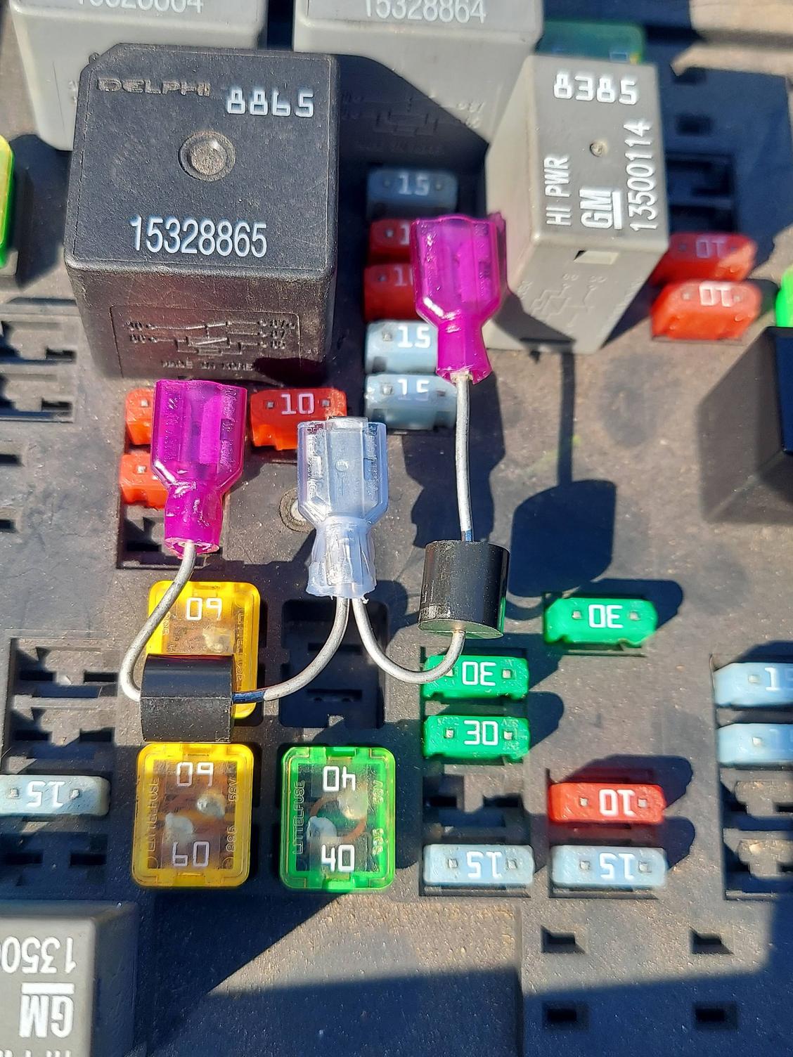

after looking at this a little more, it looks like 2 - 15 amp diodes and 3 mini fuse power taps will do the trick
I added the relays and everything is working, DRL's on while both high and low beams are on (with no trouble codes) but I think the listed material will make this work by tapping into the fuses on the power side with very little wiring.

Default 2008 / 2009 DRL mod
Very simple mod to have the DRL's on while the high and low beams are on with the 2008 / 2009 models

I purchased the mini taps from a local Autozone,
The diodes are installed with the shaded ring closest to the blue terminal (DRL fuse), the mini taps need to be installed on the power side of the fuse so when powered on the high / low beam fuse does not carry the added load of the DRL's. For the 08 when facing the fuse box on the fender side the power side of the fuse is on the right hand side.

I tapped into the hi and low beam headlight fuses with the pink terminals and then the blue terminal is the DRL fuse.
My H2 is a 2008 and can get you the fuse numbers but if yours is not an 08 they may not match,
