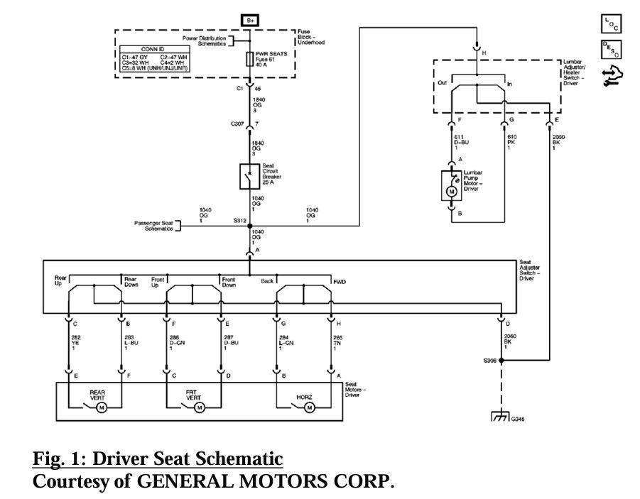

Old Jan 24, 2024 | 10:32 AM
This schematic may help
