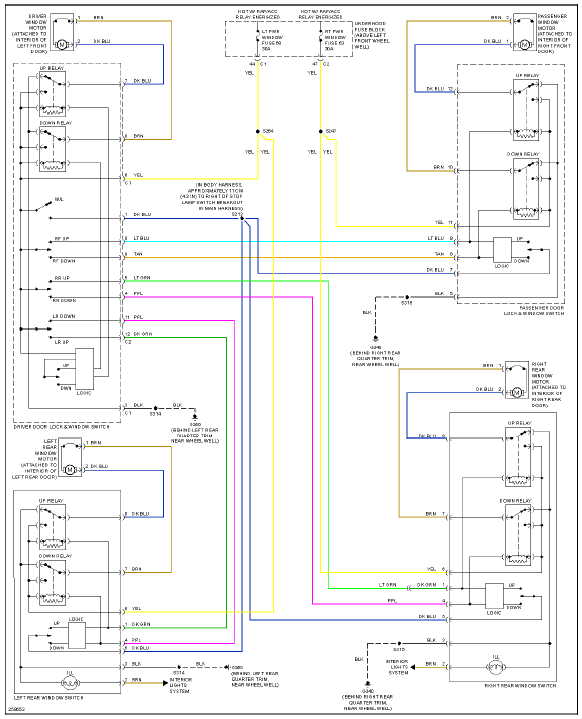

Always start with the wiring diagram if you can. As you can see, there is no white wire related to the power window circuits. Grounds for the power windows are in the back behind the quarter panel trim. Based on the other three windows working, your problem can't be the grounds and can't be the fuses since those items are common to the other three windows. That means its in the wiring, switches, relays and motors specific to the front left window. The driver door window circuit is pretty simply - a switch, a logic circuit, two relays and a motor and a foot or two of wire. The first three items are all in the driver door switch panel, but since it is fairly new its unlikely to be corrosion and more likely to have failed, especially since its an aftermarket replacement of OEM.
To rule out the switch panel you can backprobe the connector and check for power on pin 7 (DK BLU) or pin 8 (BRN) while operating the switch.
To rule out the motor you can disconnect the connector then jumper 12 v and ground to the motor and see if it runs.
The aftermarket switch panels have a reputation for poor quality and high failure rates. If that panel has failed bite the bullet and buy OEM while they are still available.

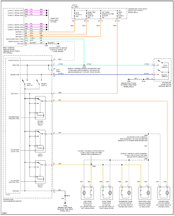

The connection between your door lock code and the power windows is the logic circuit in the driver door switch. The BCM is saying its connection to the logic circuit is grounded. It should be open, suggesting the logic circuit has failed. Here's the door lock wiring diagram:
Thank you for this, I've entertained just getting one of the GM originals' from RockAuto, but where I'm at in good old Soviet Cannuckistan (Canada), the price is...a little ridiculous and out of my price range right now, as I currently have to do a front brake job and get new tires all around too x_x
I did test the switches with a multi-meter while it was connected and also had a power-source to make sure the window motors worked, which they do. I guess I have to see if I can snag a decent test-light probe and see what's what. I'm thinking that maybe there's a broken/rubbed through wire in the door harness connection point where it goes through into the main body? (The accordion boot looking thing between the open door and body? Not sure the name of that) I just have to wait for a decently nice day to go work on that, as I can only work outside. I have also heard tell that it could be something simple as corrosion on the 'bus terminal' connector where the harness hooks from the door into the body on those pins that you mentioned causing things to go screwy, so I'm going to check that as well since I'll already be in there. Might even pull the whole driver door off to adjust the hinge position as my body lines are kinda skewed there too, make a weekend thing out of it. Lol.
Thank you again, I'll see if I can get this diagram blown up a bit larger so I can print it and keep it with my 'Hummer folder'.
Thank you for this as well. Going to save/print this so when I get to it, I'll have these in front of me ready to go.

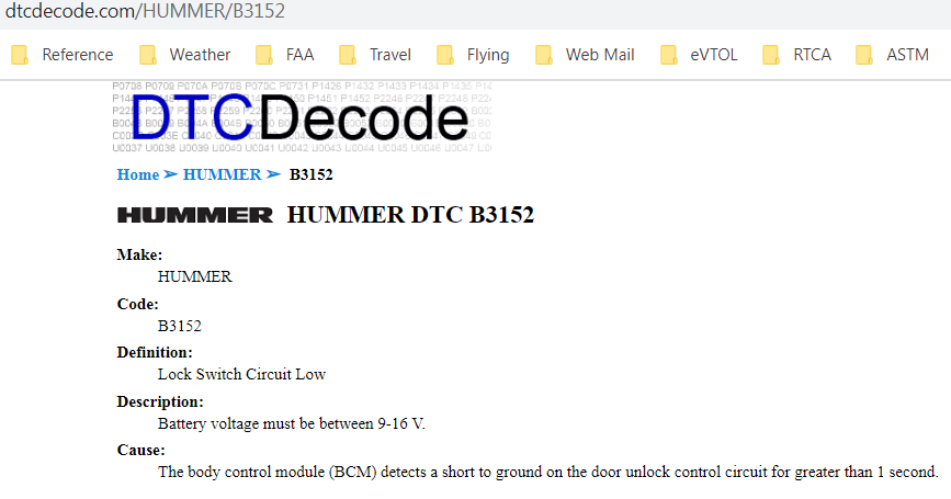

This is a great resource for the meaning of Hummer specific codes: https://www.dtcdecode.com/HUMMER
