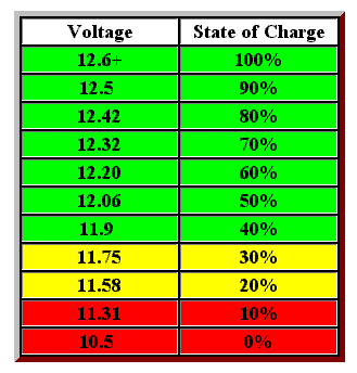

Also monitor resting voltage.

Please follow up and let us know if the Battery Terminal Connectors do the trick after you confirm resting voltage. There are other possible things to look for, but easy known stuff first.
