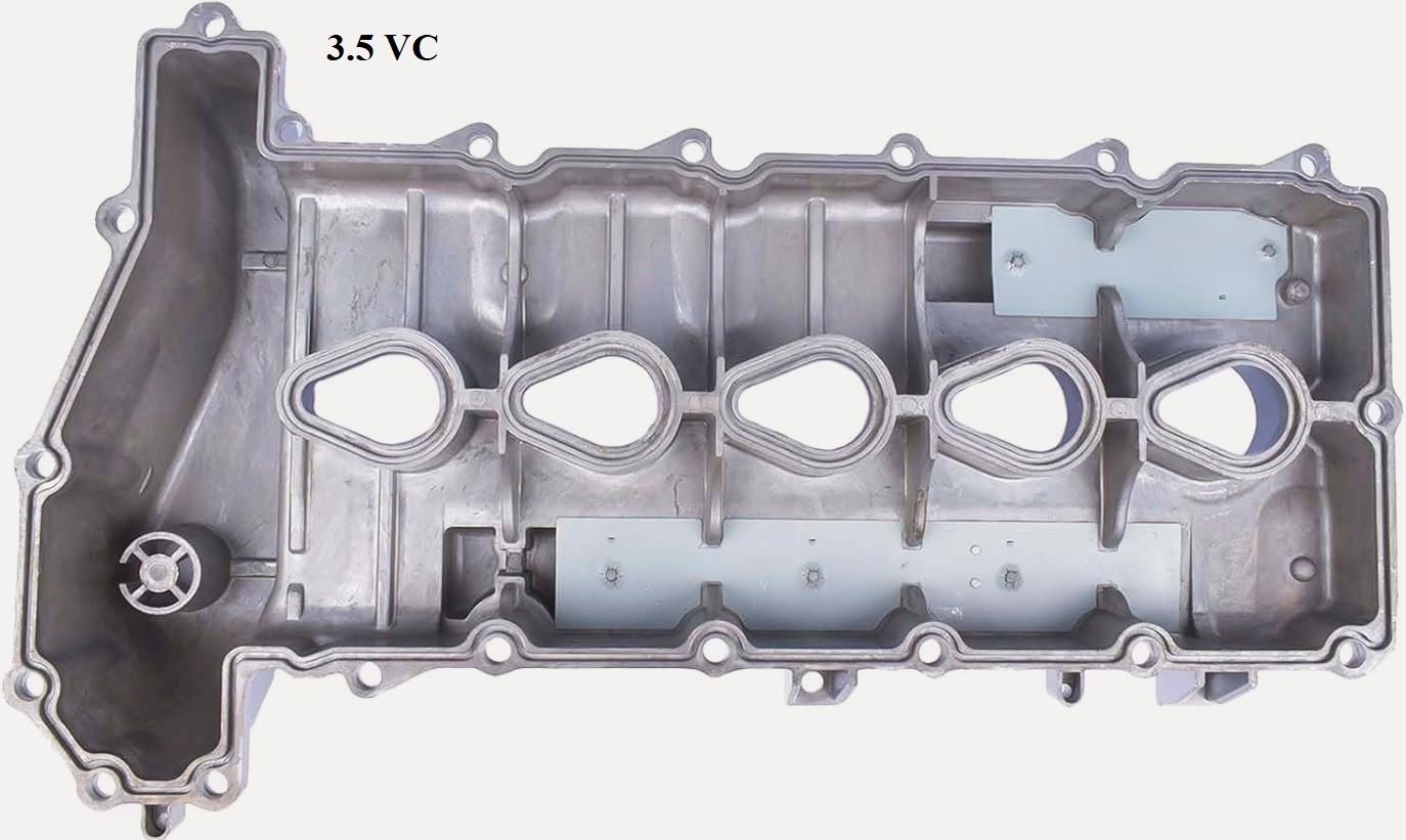

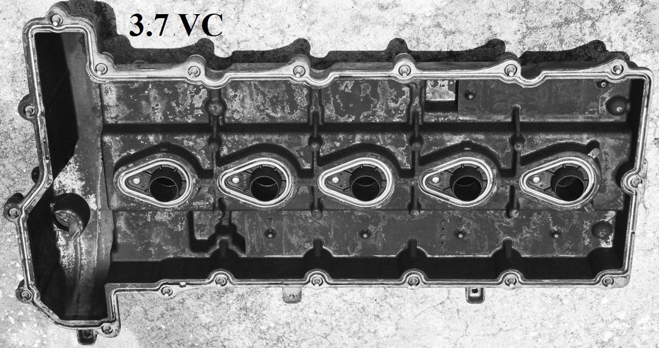

I need to replace the valve cover on an 07 H3 3.7L, I am finding tons of 3.5L valve covers but nada for a 3.7 thats new. Anyone know if the 3.5L would fit? They appear to be identical.

Old Feb 22, 2024 | 12:38 PM
Well, they are not interchangeable.... The 3.5L has different shaped spark plug wells than the 3.7L so there is no way for the gasket to seal, and the 3.5L is plastic, not aluminum. The other difference is the 3.7L uses a smaller VVT wheel so that is likely to cause issues as well.

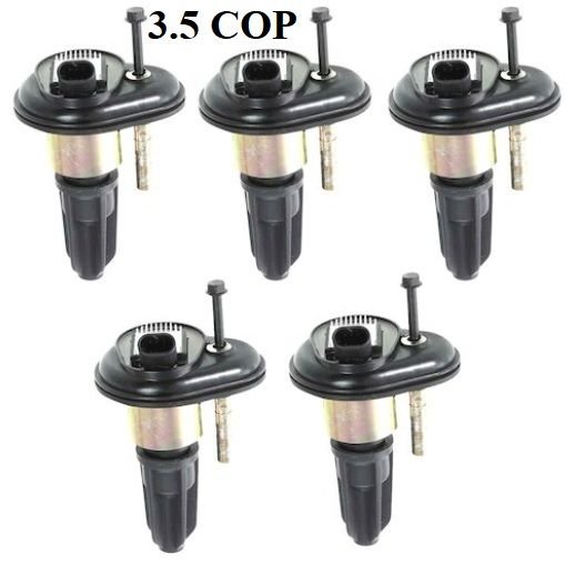

Different COP design, same look under.
Old Feb 23, 2024 | 01:18 PM
Not the same look to me? The 3.7L uses integrated cups that allow for the spark plug wells to seal, the 3.5 has none. I asked a customer of mine who has been driving Chevy Collys for a while and he says without a doubt, they do not interchange as I mentioned.
I have never tried so I am relying on a trusted source. If you want to give it a go, have at it.
