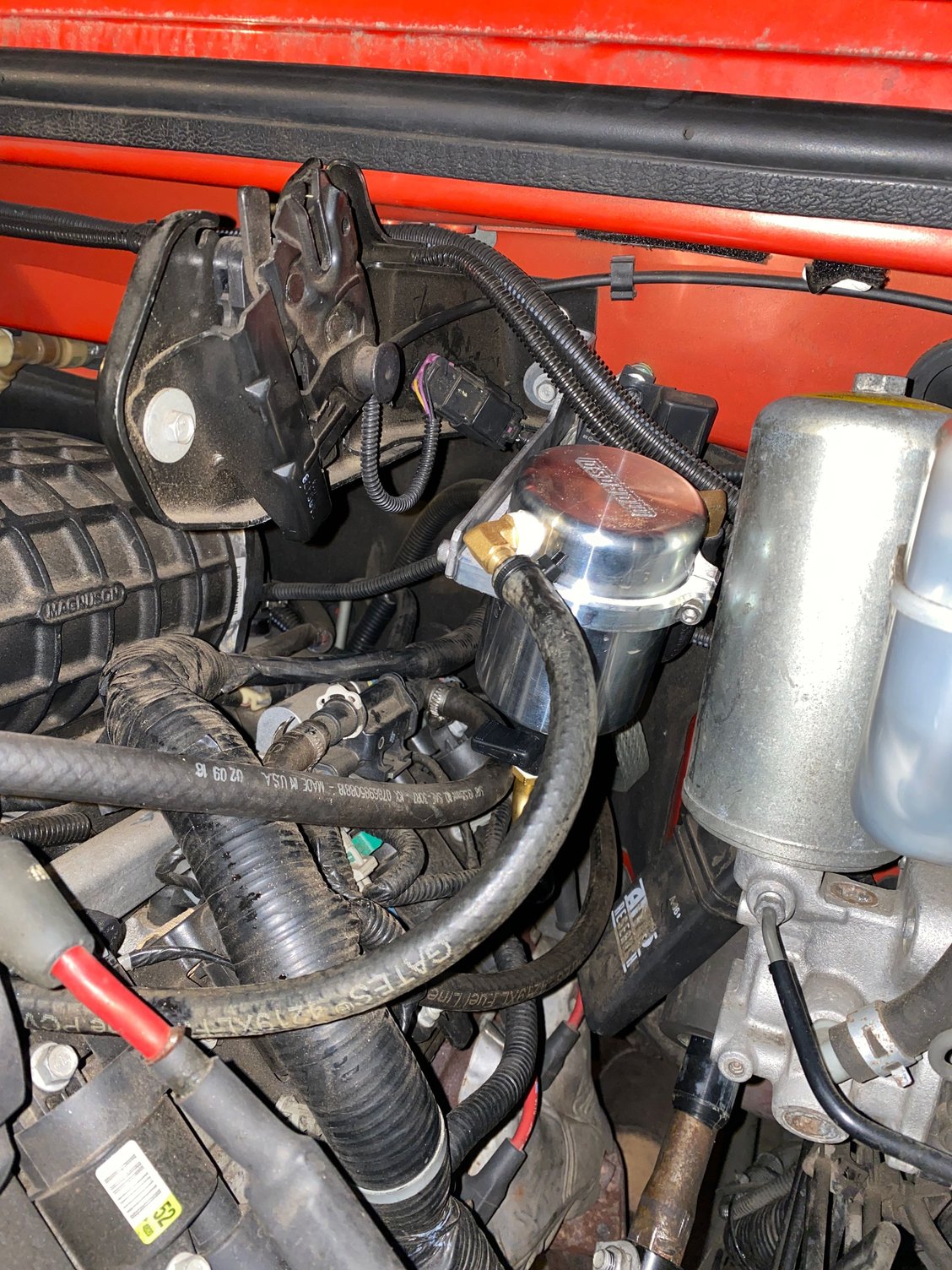

Originally Posted by legerwn
I don't see a catch can in the PCV line which can cause a lot of issues on a boosted engine especially an LS engine. The valve cover baffles are known to be sub par for the job they are meant to do. Its likely if you were to pull that line off the vacuum port it will be full of oil along with the blower and intake. GM recommends the replacement of the driver side valve cover with a new one when oil is noticed in the intake. Mine had over a quart of oil in the intake when I pulled it and there is no easy way to get it out. If the PCV is passing oil to the engine it can contribute to the noise your hearing, not saying this is your issue but it can be.
Have you had to add oil to the engine?
Neal
Sorry it took so long to get back to you. I thought my post posted a few days ago but it didn’t. I’m taking your advice and I installed a moroso catch can that I’d seen someone else install on this forum. The pcv line was drenched when I removed it. But I couldn’t tell you if that’s why I had to add oil because of other leaks. Though I just got those fixed as well.
Also plugs and wires just came in. I will be tackling those myself on Saturday as well as getting a borescope to see about carbon deposits.
here is the catch can I purchased. It seems to have just a bunch of steel woolish stuff on top where the lines go in and a baffle. Nothing too fancy but it’s supposed to be one of the best. I mounted the bracket on my hood latch bolt.
https://www.amazon.com/Moroso-85481-...ps%2C84&sr=8-3
Mark each plug to show what cylinder it came out of and post pics here.
