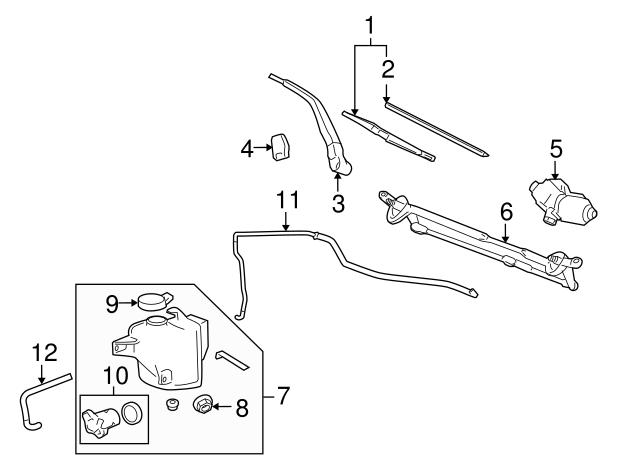

Does your rear window washer work? I believe that is the line that takes fluid from the front to the back (similar connector under the carpet just in front of the driver's seat if I remember correctly.
Old Jan 25, 2019 | 05:27 PM
650Hawk's Avatar
Joined: Jun 2015
Posts: 796
From: SoCal

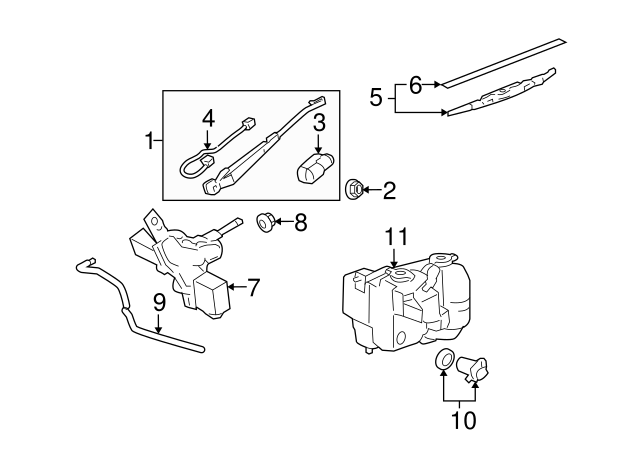

Yup, that is the line to the rear washer. It goes from under the washer tank (passenger side, just behind the coolant tank) up under the cowling, across to the driver side, then comes out and down (that's the part you are looking at) and routes along the frame to the back of the truck, and goes into the rear door. The washer fluid tank has two pumps under it; one for the front, one for the rear.

Now we know what it is, I am trying to find a replacement and it isn't listed on the GM Parts diagrams for either washer pump?? Anyone have a clue where I can find it please?
Hummer H3 Front Washer Assembly
Hummer H3 Rear Washer Assembly
