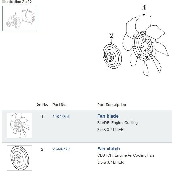

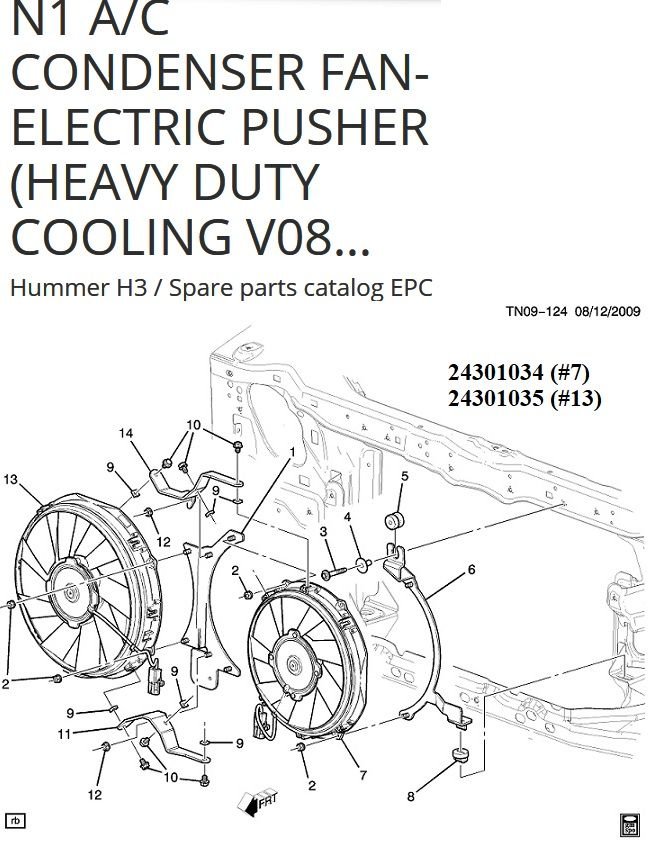

Welcome to HF. Your PN comes back to an auxiliary electric fan. An add on, not as built.

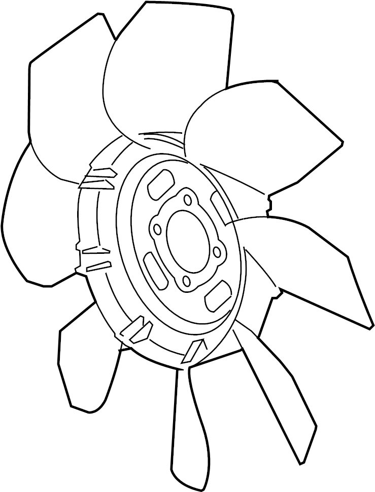

Are you asking about US built H3s, because they have all use a mechanical clutch fan. BLADE,FAN(ACDelco #15-80698)
Old Jul 10, 2020 | 12:51 PM
Posts: 9,014
oem part numbers 15877356 & 25948772

not to thread hijack but i got a newb question. This was an add on but can this work with 07 as well?
Old Jul 13, 2020 | 01:07 PM
Posts: 9,014
Option for 09-10. You can make anything work on and 07, however you're going to need mounting brackets, and wiring harness.
Old Jul 13, 2020 | 01:09 PM
Lord_Vien's Avatar
Joined: Jul 2020
Posts: 115
im assuming this would have to be run on a relay kit and thermostat as well? or is there a plug and play harness?
Old Jul 13, 2020 | 01:21 PM
Posts: 9,014
You would need an auxiliary fan control unit.
Old Jul 13, 2020 | 02:13 PM
Lord_Vien's Avatar
Joined: Jul 2020
Posts: 115
ahhh gotcha, what you think about a relay control unit that has a fin probe for the temp sensor to kick the fan on or something that has to tie into the factory stuff?
Old Jul 13, 2020 | 02:32 PM
Posts: 9,014
Probe or coolant sensor, either way, you don't want the fans running constantly.
Many options available on ebay---> hummer h3 auxiliary fan control unit
