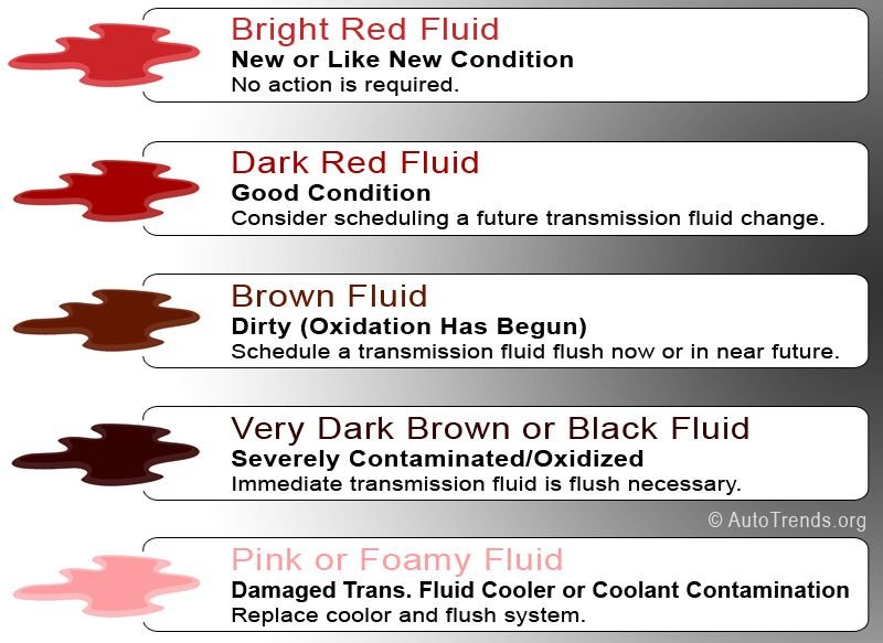

When was the last time you changed the Trans Fluid and Filter? Check the Trans Fluid and wipe dipstick with white paper towel/cloth to determine level and quality.
