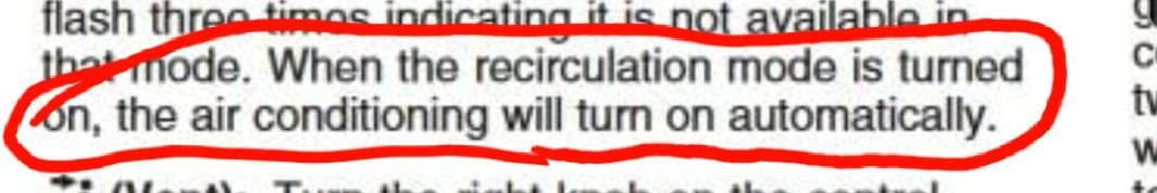

Default Depends on the mode
Air conditioning system automatically activates with defrost and defog:

Well, I guess it does turn on. I must just have missed it. Granted it was cold outside when I tried.
Thanks for the post hummerz
