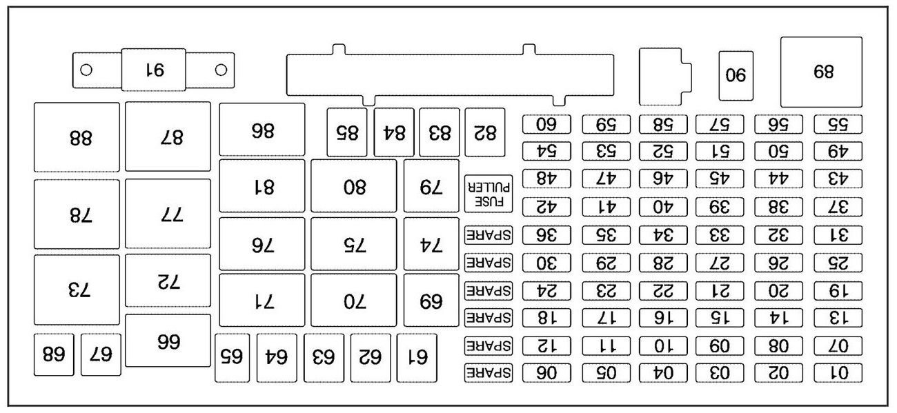

The aux outlet on the left is fuse #51, the aux outlet on the right is fuse #45 and shared with the cargo aux outlet. Check rear aux outlet.

In need of more assistance? Looking from front, start from top right(#55) and count 3 fuses left & 3 down, should be yellow(20amp)
