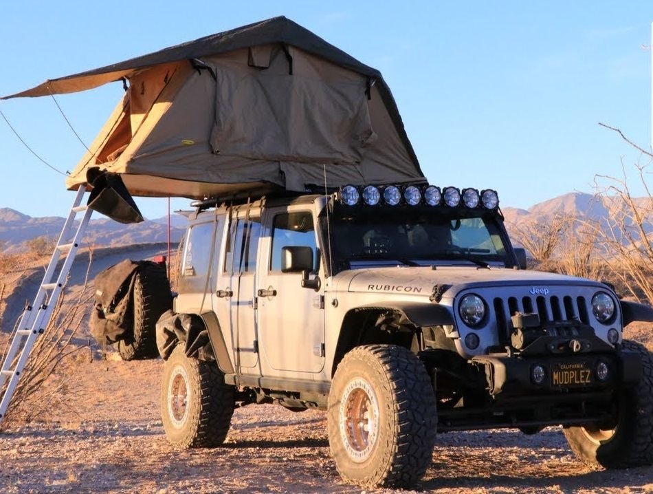

Thanks for all the responses. I called the manufacturer of the rooftop tent and they said that I would have to have aftermarket rails done. That the weight of the tent plus the occupants would be too much for it. They said it could damage your roof. So we are going to just look into a travel trailer.

Not hold the weight? What did you miss? Btw, why would anyone go camping and install a tent on the roof? Pitch a tent on the ground or get yourself a camper! It must be a cjeep thing:

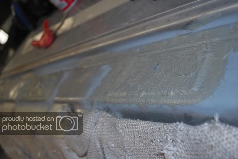

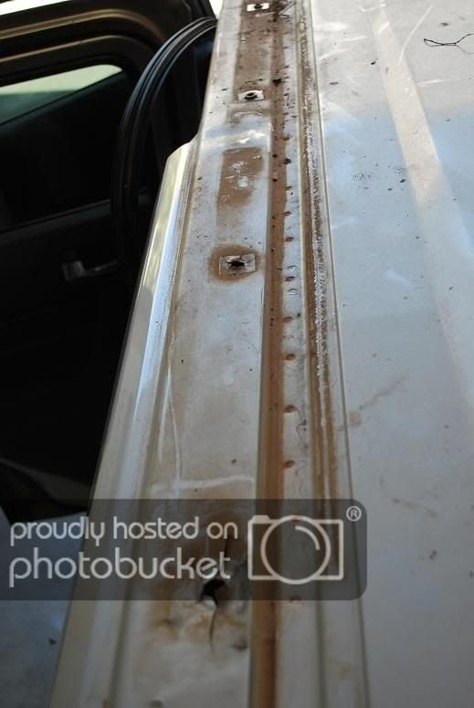

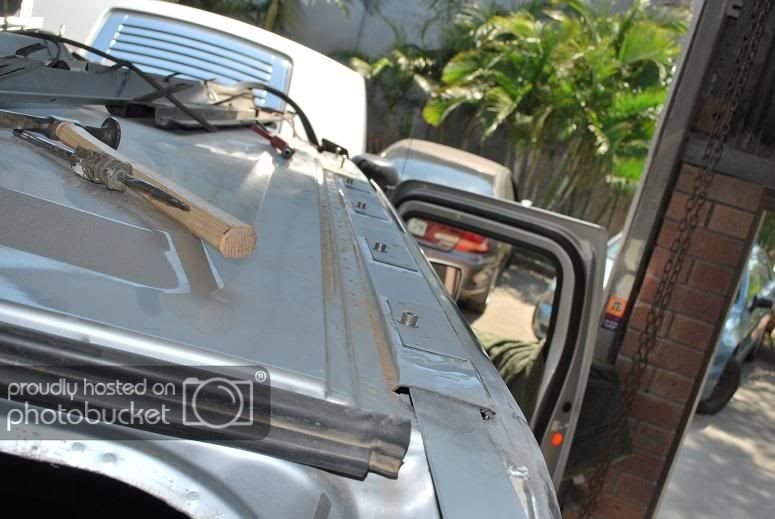

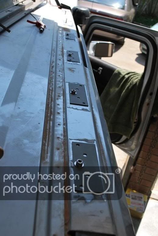

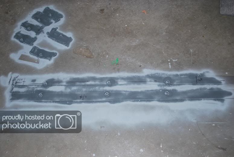

Originally Posted by hummer_on_fumes
In the past I remember Tainter saying that if you are putting more than 200 lbs on the roof you want to remove the head liner and reinforce all of the roof track mounting areas because they are only rivnuts. There is a 200 lbs maximum counting a roof rack. Putting 700 pounds on the roof sounds like a risk of causing a roof leak in the future.
TRUE! the riv nut will pull right through, cracking the thin metal beneath it.
This is Nugget (long time H3 owner and avid over-lander from down under) who had 120KG (about 265lbs) on his roof every day.
He ripped the RivNuts through the metal.
Once he had sandwiched the thin roof metal with a plates above and below to distribute the load through out the entire roof rail per side he had no issues.
He also used multiple mounting points on the roof rail to distribute the weight. 2 Roof racks ain't gunna do it, OEM or not.
