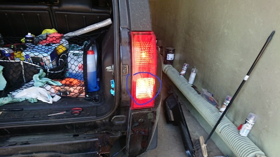

Only thing I am not certain, should breaking action illuminate turn signal bulb?
I have never paid attention, might be specific to American car or something is broken somewhere else.
Old Jun 24, 2020 | 02:03 PM
What is circled is the reverse light, not the turn signal. Brake light/tail light bulbs are dual filament, one filament lights for brake and the other for turn signal. Same location.

Thank you Doc, I then will assume everything is as it supposed to be!
I live in Europe and never seen such configuration rear light(not that I have much experience with cars).
We are not even allowed to have reverse lights in that location, We need to move reverse lights outside, mine sits on my rear bumper, bottom.

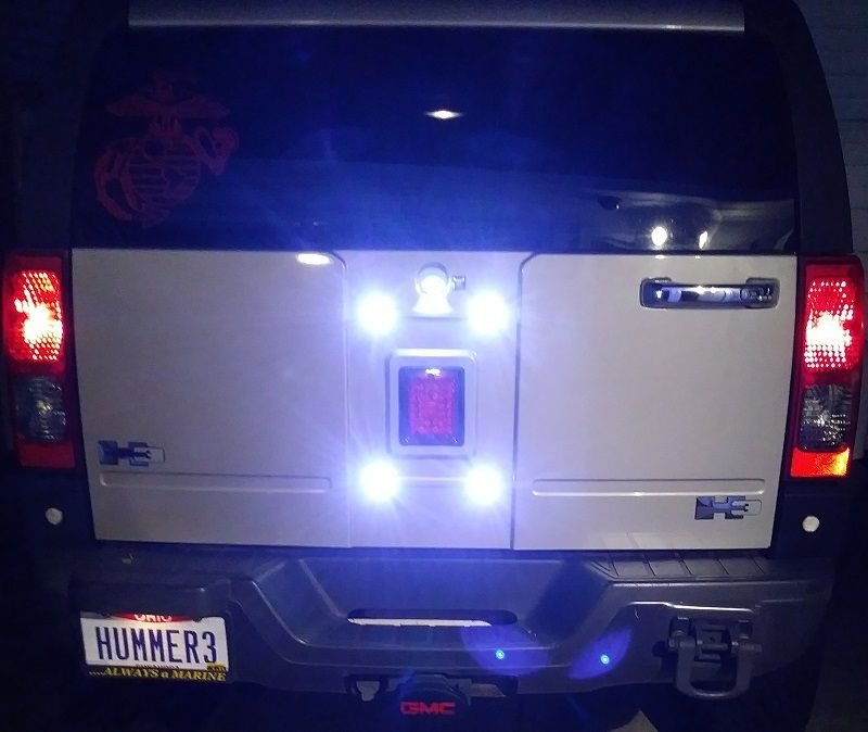

Old Jun 24, 2020 | 09:13 PM
Posts: 9,014
3157 incandescent bulbs pull 2+amps each. Switch out to led bulbs. I installed 5 led reverse lights on the cargo door, and all 5 combined, pull less than 2amps.
