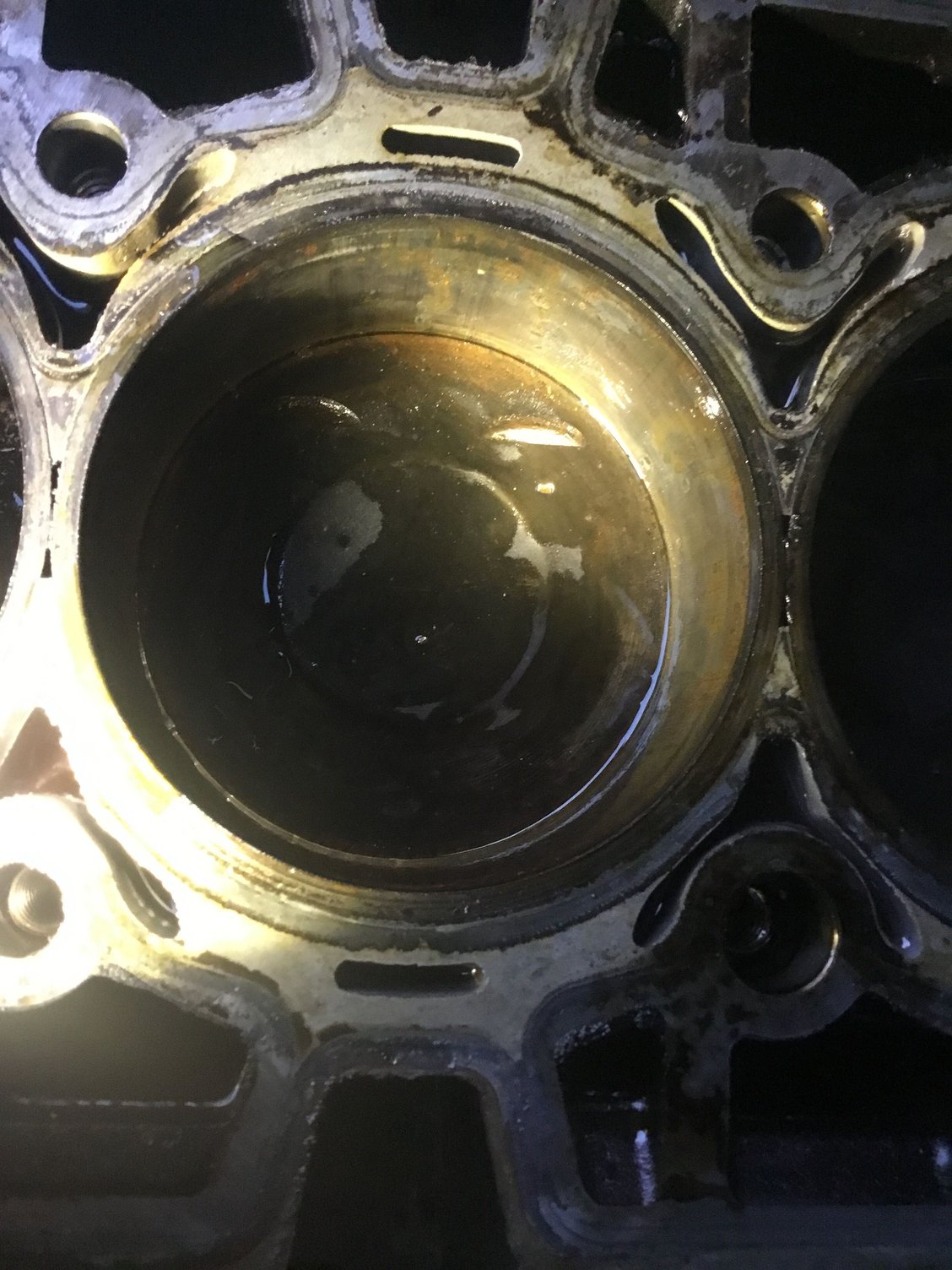

This photo shows the extent of the piston damage

This is the scuffing on the sidewall of the cylinder #3.

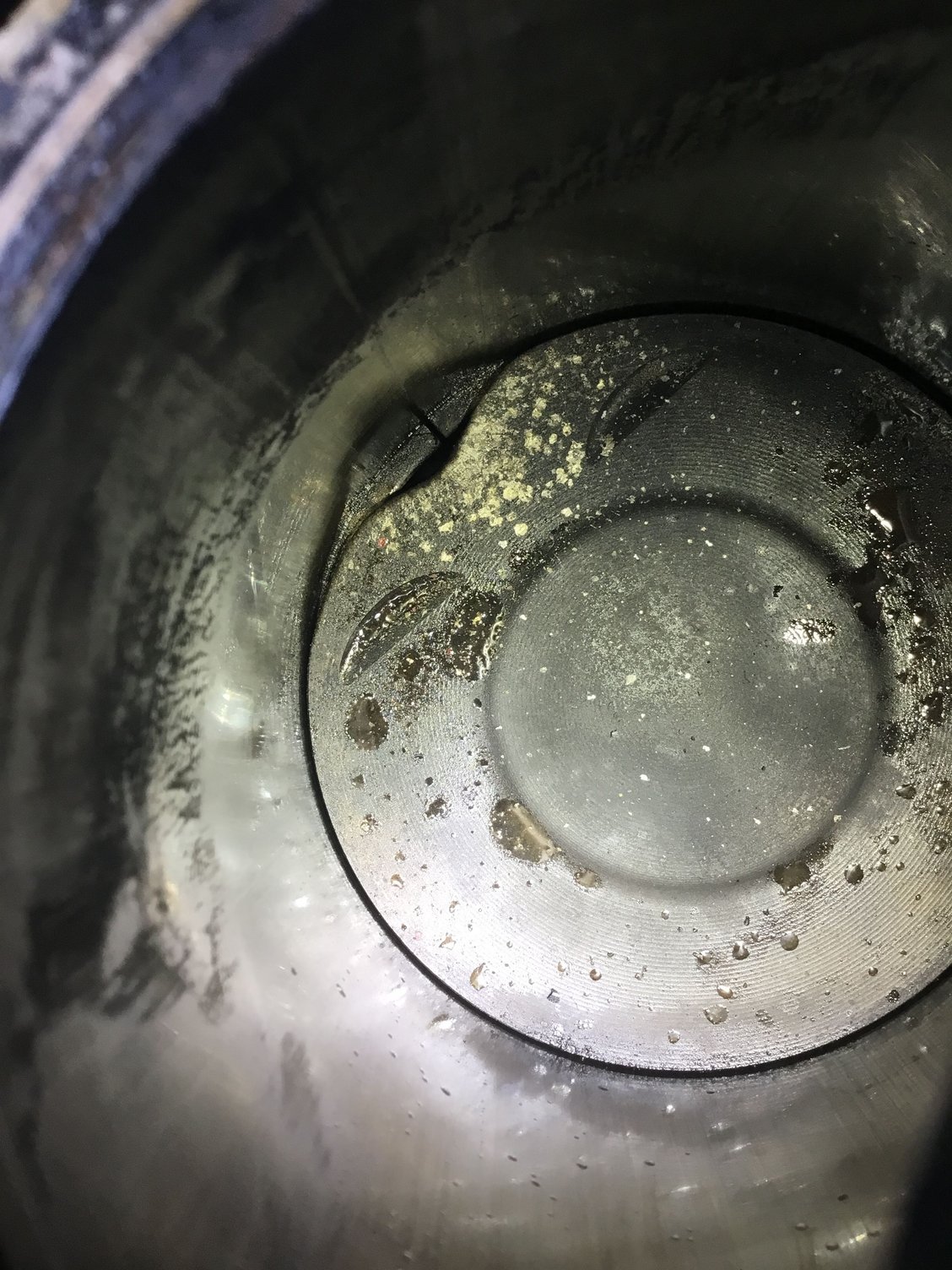

This is the same angle of the sidewall of cylinder #4

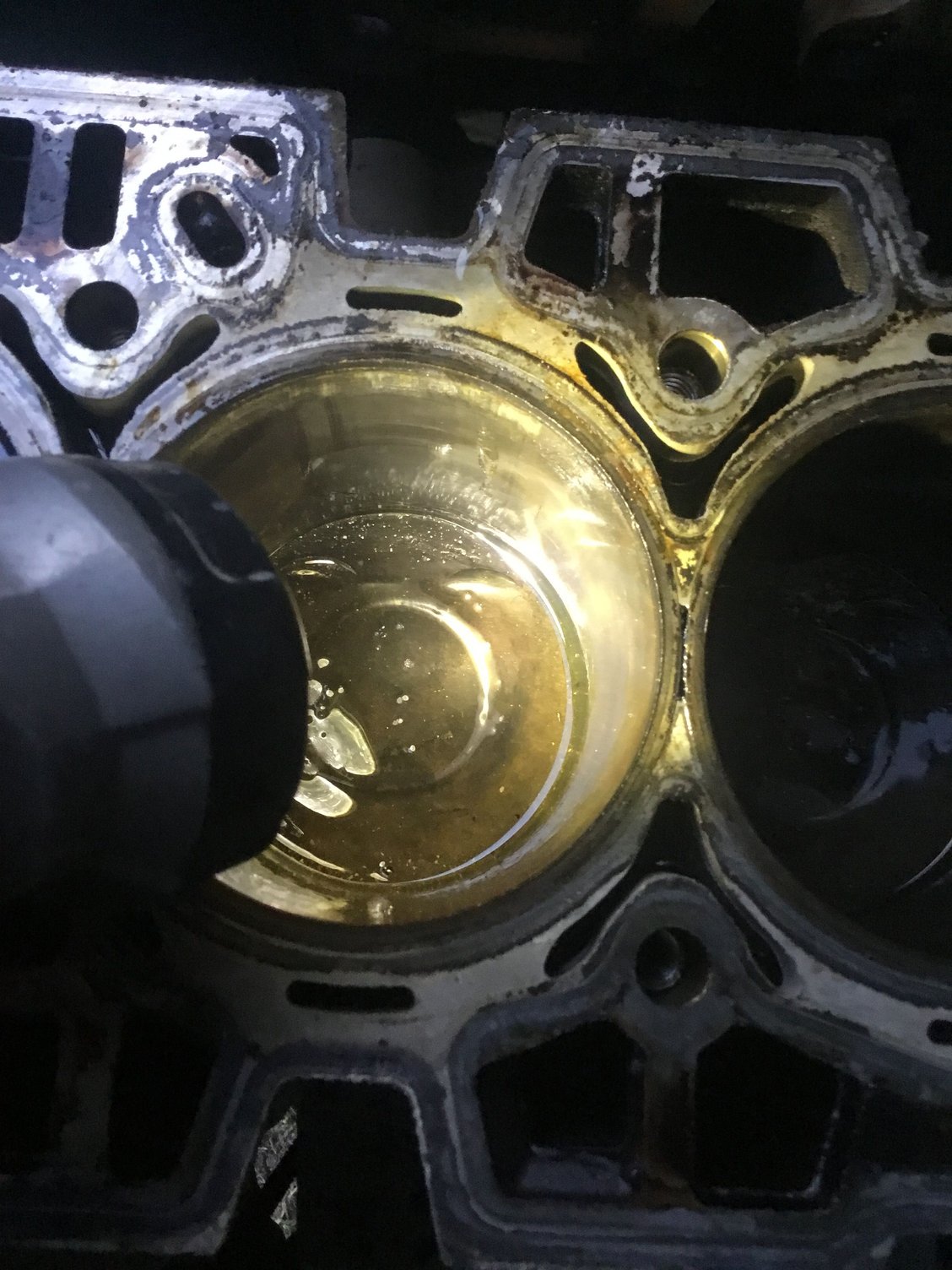

This is the same angle of the sidewall of cylinder #2.
Old Mar 15, 2021 | 02:31 PM
I doubt I would spend the time to replace the pistons and lower end to bolt it back together. Better to look for a used motor or re-manufactured motor.
Coolant does not eat or blow a hole in a piston. The radiator leaked or burned out coolant, got way too hot, had a blow by situation going on that side of #3, the hot gases kept blowing by in/through that leak and finally got the piston metal hot enough to burn it. Like as in bye bye its gone and in the oil. That more than likely has #3 cylinder out of round, not to mention what is going on in the bottom.

Thank you doc olds, I was afraid of hearing that.. I still have to explain it to her, so I’ll have a little chat with her and explain the engine with that mileage and had that problem for some time it’s time to get a new engine, unfortunately she is still paying on the it! I was just wondering though you said the it got hot and the blow by has caused the hole to arise but where would all the coolant leak from?? To move that quickly from the radiator to the oil pan. Thanks again!

Thank you happy hummer. I couldn’t find the obvious head gasket leak but I was throughly looking at the coolant jacket to the cylinder walls. Maybe the leak was from the head gasket between the oil cavity and the coolant jacket. As for the hummer I don’t know the fate yet. Definitely going to examine the bottom end better. Thanks again for everyone’s input!
Old Mar 16, 2021 | 05:52 PM
Posts: 3,204
looking a bit better at your picture it looks like it had a really bad exhaust gasket leak at that cylinder.
the rest of the exhaust manifold ports are normal rust colored but that one is carbon black all around even the mating surface. a bad exhaust gasket can damage a piston like that.
